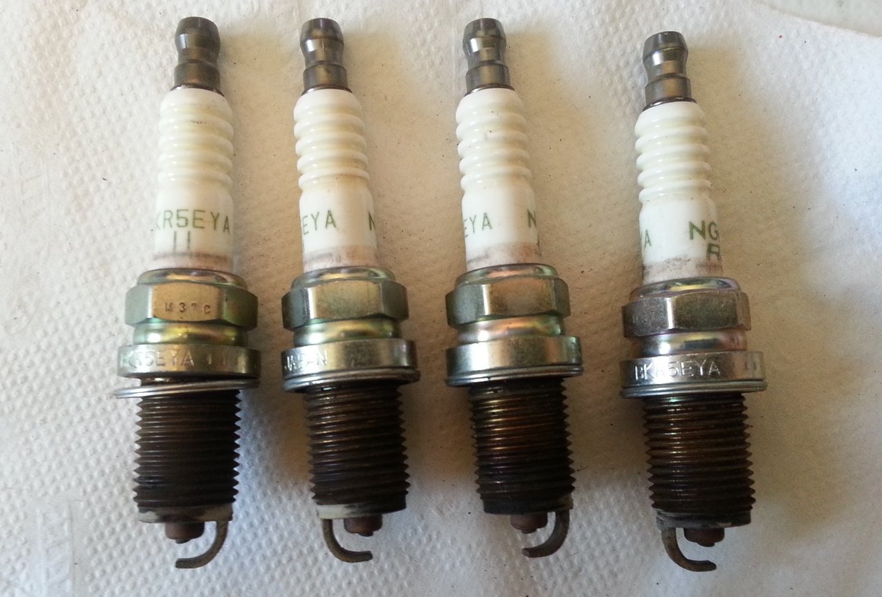

    I found four NGK v-power spark plugs in my 2RZ-FE engine today. the gaps are 0.062~0.064. Could those be the original plugs? it's been 11 years and 115xxx miles
    Also, does the plugs look too dark?
