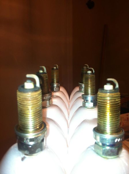

    Here are pictures of the original spark plugs out of my 09 with 112,000 miles. I changed them today and it was not too bad, took about an hour. Before changing plugs I was averaging 18 MPG hwy and city. Hope I get better MPG now.007.jpg And thanks for the write up on the DIY. Very helpful. I find the majority of the post on this site to be very helpful!

    Wow... You got 112,000 out of your first set of plugs.?? That is amazing, kinda makes you wonder why people change them every 30,000.

    I bought the truck used with 92,000 miles on the clock, It drives with plenty of power and getting pretty good fuel mileage, I could not see on the Toyota owners site where this vehicle had the plugs changed in service so I wondered about it. I will not wait this long again even though they were easy to remove, I was worried about the threads sticking with them in there that long but no worries. I hope I get as good or better mileage now so I will update later.
