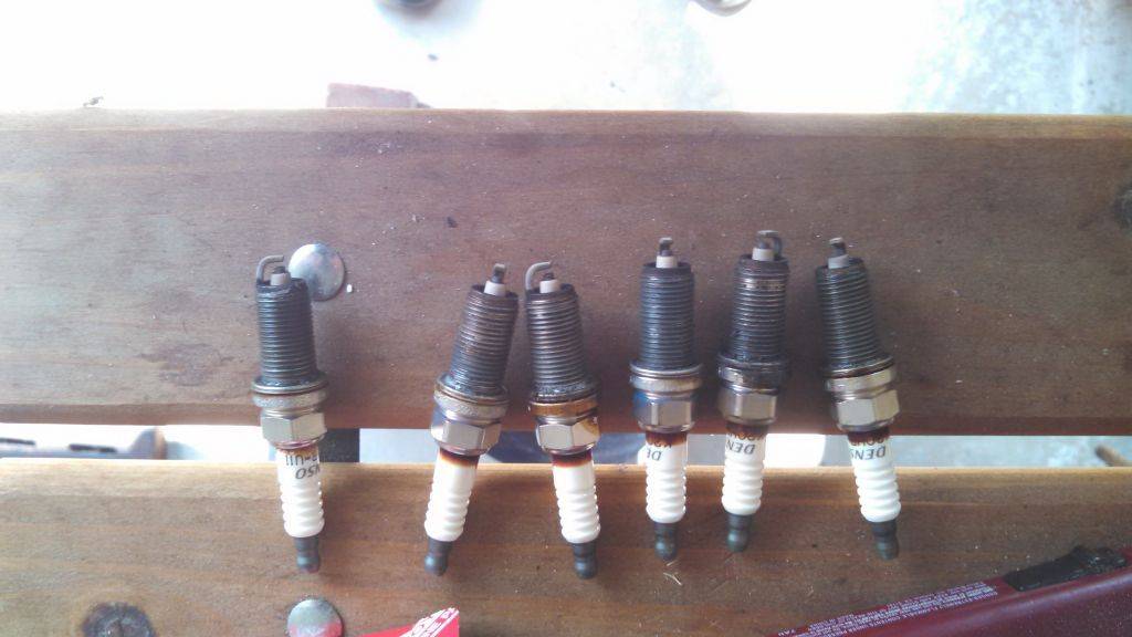

  20. Jul 4, 2014 at 2:10 PM
    #1360
    quantum
    quantum Well-Known Member
    Apr 23, 2013
    #102694
    1,503
    Easy-peasy
    Left to right: P-REAR, P-MID, P-FRONT, D-FRONT, D-MID, D-REAR
