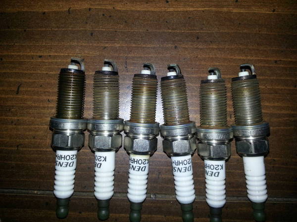

    anyone see any problems with these? between 40-43k miles on these plugs since the last change

    They look good.

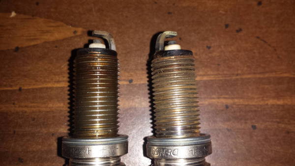

    Awesome write up, thanks Chris! Plug change went easy except now I'm a little concerned after inspecting the plugs.
    The plug on the left (drivers side, closest to firewall) appears to have oil on the threads and smells like oil. All the others smell like fuel and look fine to me. Here's a close up.
    Pretty damn sure it's oil. Truck has 60k mi. on the odometer and have kept up with maintenance religiously. What's going on in that cylinder?

    Those look exactly like mine did! And my plug closest to the firewall on drivers side looked like too.

    Cool, thank you for the reassurance. I've since poked around the forum and found more of the same responses. I just had that initial panic and posted here before searching :p

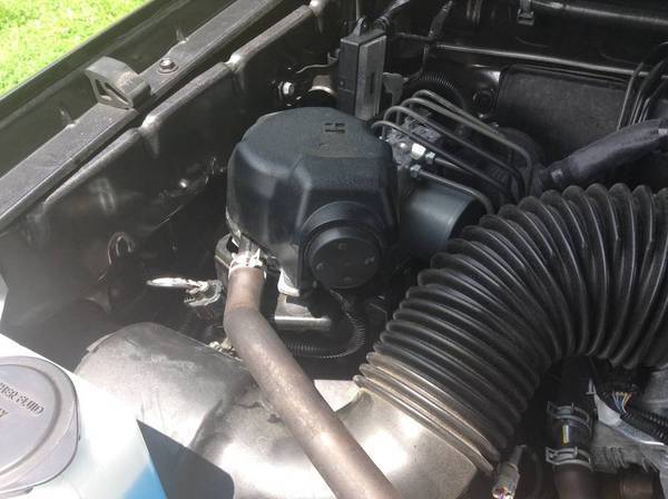

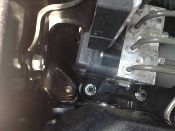

    Great write and easy to follow. One thing, one the 2013 (and I assume 14's) this is in the way of removing the air intake:
    I removed 2 of the 3 10mm bolts and loosened the third to access the 2nd air intake bolt.
  16. Jul 20, 2014 at 10:00 AM

  17. Jul 20, 2014 at 10:02 AM

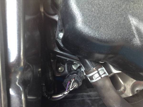

    Tint and tonneau for now
    You can see the intake bolt buried under the harness.
