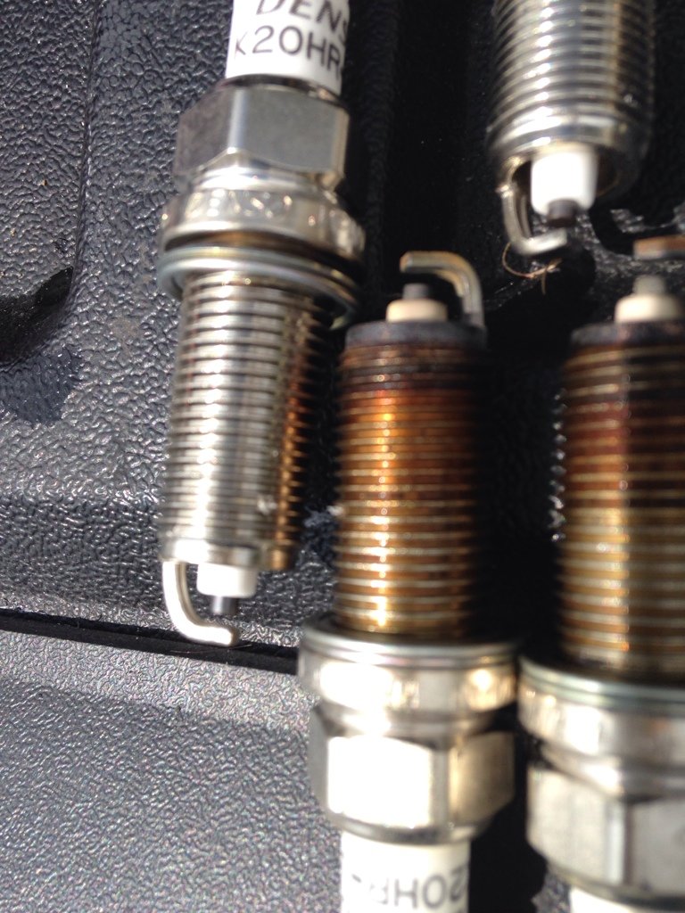

    After 30k miles on my plugs vs new ones going in.
    Only took about an hour to do first time. Easy peasy
