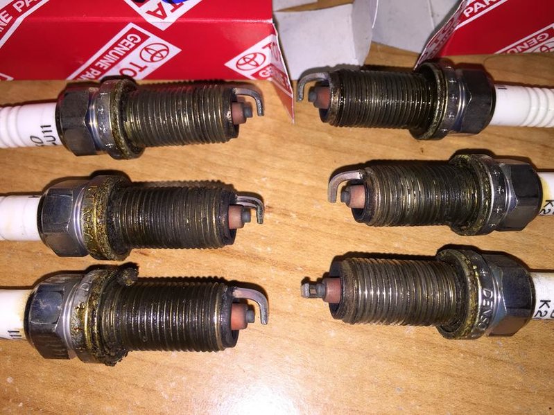

    Changed my plugs today.
    It feels great saving a couple of bucks!
    However, the old plugs look really bad. Especially the threads. I wonder if it is the anti-seize I used. Also, the center electrode porcelain is red. Anyone know what that means?
    Rcky

    Plugs look good, but use a little less anti sieze.

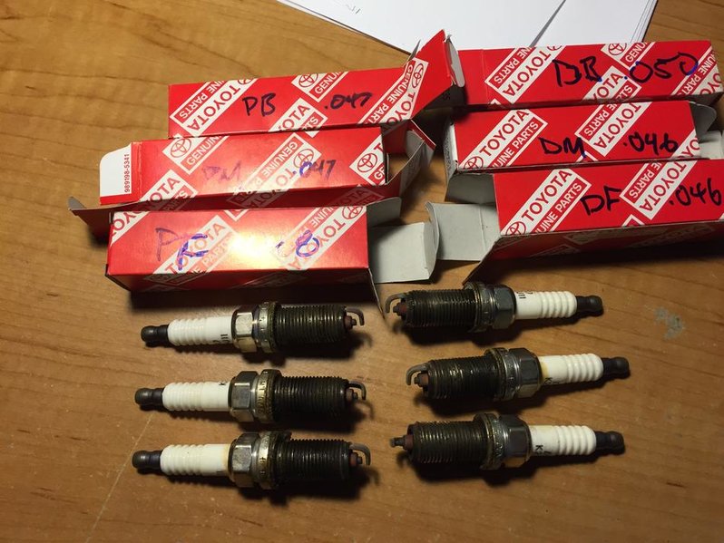

    Awesome info thanks. Changed my plugs today. Took about 90 minutes.
    Here are the old plug gaps
    1L=0.050"
    2L=0.051"
    3L=0.050"
    1R=0.046"
    2R=0.045"
    3R=0.046"
    Anyway, I had a lot of yellow around a couple of my plugs.
    I will upload pics here shortly.
