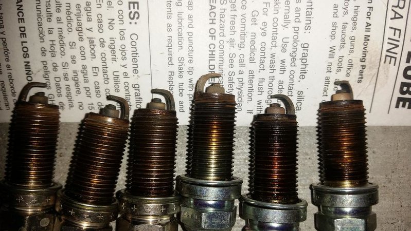

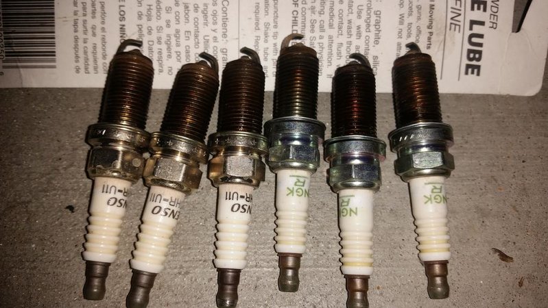

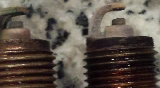

    I just changed my spark plugs for the first time using this write-up on my phone as I went and I must say, I couldn't have done it alone. It took me like Chris suggested - about 4 hours including a trip to the auto parts store, but if I were to change them again I bet I could do it in about an hour. My truck has 105K as of right now and we bought it from the dealer at 58K so I am about 15K overdue for the plugs. Little did I know, the previous owner nor the dealer had changed the plugs, so these Denso and NKG plugs have 105K miles on them!!
    As you can see, they were gapped at 0.090 to 0.10 which is way out of spec! Strangely enough, however, my truck ran great and gets awesome mileage with the right driver. Below are pics of the 105K used plugs. Big thanks to Chris for this write-up.

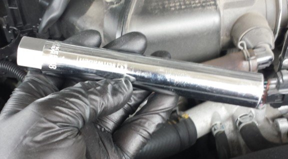

    First picture shows original spark plugs after 41k miles. On left side is Denso and on right side is NKG. Denso plugs were in decent shape.
    Second pic shows really nice spark plug socket, it is magnetic and longer so don't need worry it will fall down in spark plug hole. I got this one few years ago for spark plugs replacement on audi. It is perfect for Tacoma too.
