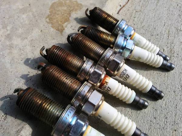

    Thank you Chris 4x4 for posting this!! I changed out my plugs today. Super simple the original plugs were still in there with 129,749 miles on the.

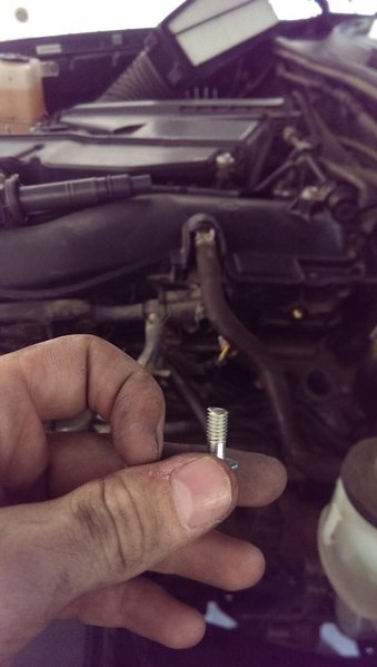

    HELP
    soooo what now?? how bad am i F'd??

    I would put the plug back in (to keep shavings out of the hole), get a very good drill bit, and start a small hole in the center of the sheared bolt. I'd then get an e-z out kit from harbor freight and slowly use that to back the screw out (remember to set the drill in reverse). some auto store may have one you can borrow for free.
    just be glad it happened in the back and not the front driver's side...

    yea i know im glad it was the one closest to the wall of the truck. the only thing is i cant get to it with a drill and im not sure what the hoses in the way are connected to. i think im just going to bring to a shop near by and let them do it. id rather not mess it up even more.
    put the plug back in and it started fine so ill just take it slow to the shop
    sucky thing is, is that it was the last step to finish all 6 plugs and i was done.

    anyone know where to find the specs of the size and diameter of the bolts that hold the coils in are?
    ive searched a few sites and cant seem to find it

    IIRC, they are 10mm. They get torqued to 7.5 ft.-lbs.

    i knew the 10mm part i was just asking so i knew what length to get and the size of the threads but i found a great broken up diagram that listed it.
    thanks for the replies and all the suggestions!

    just changed my plugs. Why are there different plugs on each side? Does anyone have a real answer? My dealer does not know (big surprise)

    Nobody really knows.

    So that we know if the plugs have ever been changed!
    At least this is my guess :)
