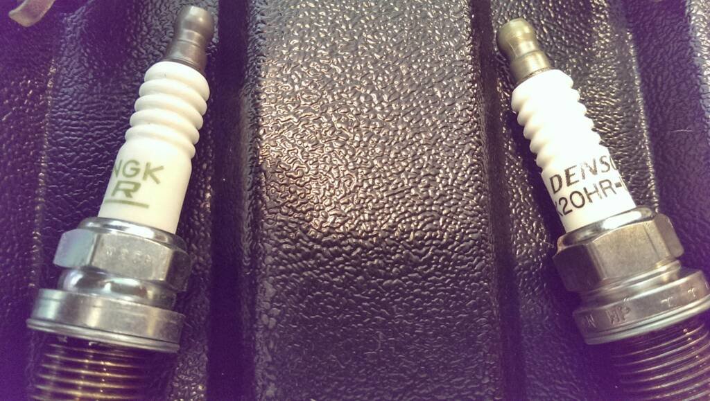

    Just changed my spark plugs (thanks for the write up Chris) and found that the whole driver's side had the NGK plugs and the passenger's side had all denzo. This was for the 30k service so the dealership shouldn't have done this right? If that is the case, has anyone else seen this in their 30k service?

    Dealers replace with all Denso plugs. If you paid for a spark plug change, Me thinks they didn't do it, and charged you anyway. Check the NGK plugs, and if the gaps are over .55, I would say they are the original plugs.

    Lucky for me I didn't have to pay for any services until this 30k which is why I did it myself. But that makes sense that they wouldn't kill themselves over doing the driver's side...
    Either way, I have some phone calls to make to the two dealerships that have serviced the truck to find out who owes me.
