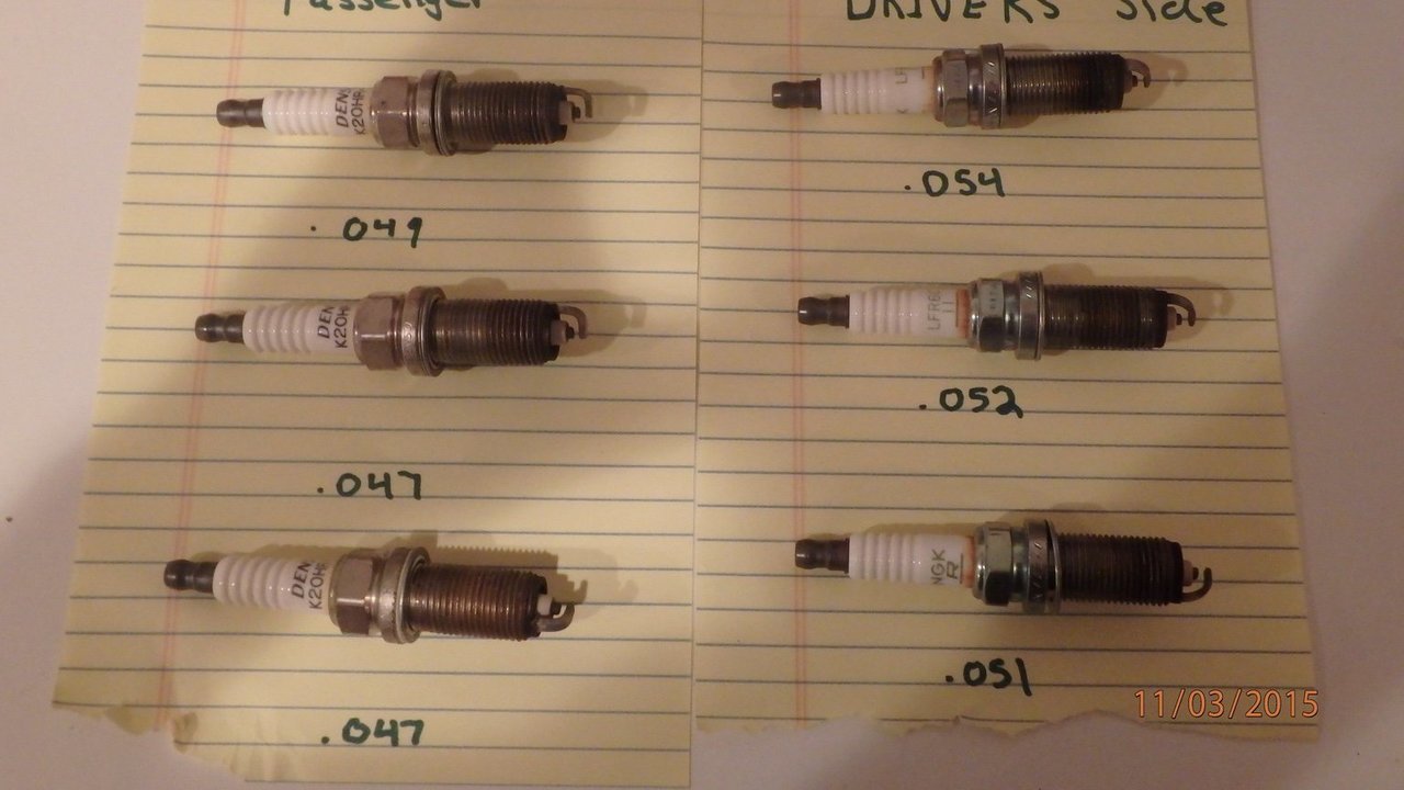

    Thanks for this great write up Chris! When I first bought my truck this was one of the 1st threads I saw and it was intimidating. I completed the job today in a hour and 45 minutes and didn't have any problems.
    Here's the plugs as they came out of the truck with 48,400 miles, they are the originals.

    Holy crap, 200k on the original plugs!?! I changed them yesterday and it had the typical Denso/NGK setup and the gaps were all off the charts on my gapper. Looked like about twice what they should be and the electrodes were all worn down to a nub. Fairly simple and straightforward procedure thanks to this wright-up. She's a little easier to start and runs a bit smoother now. I can't wait to see what else the previous owner neglected.
