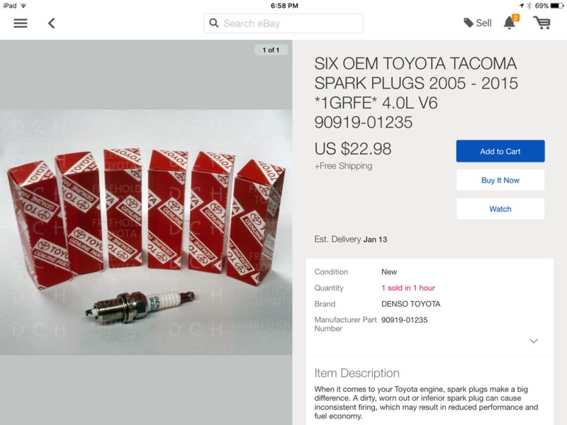

    5.73 ea at livermore toyota. Same toyota part #90919=01235 (Denso #K20HR-U11)

    Check ebay, i recently got 6 for $23 shipped
