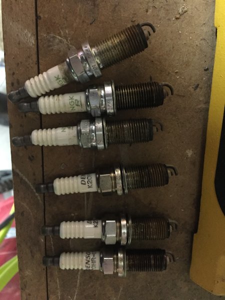

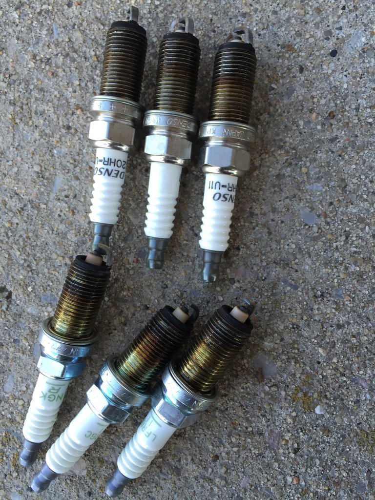

    Just did this on my '13 TSS 4x4. The Colorado trip just pushed me over 46,000 miles.
    Denso plugs that came out were at .048 and the NGK around .053 with one at .056.
    Glad I saw this thread before they got any worse.

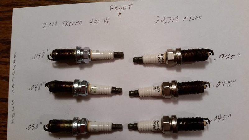

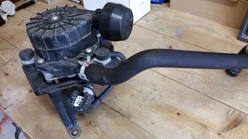

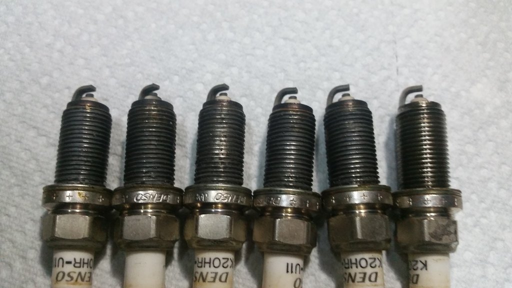

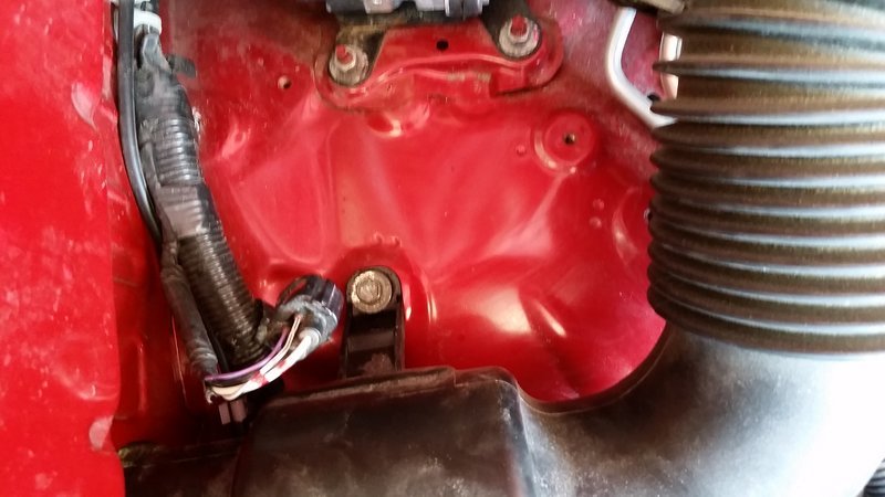

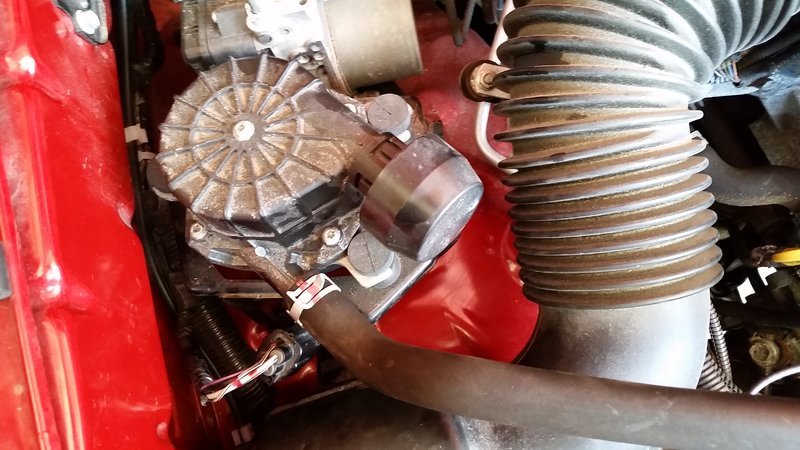

    Many thanks to Chris for writing up this how-to and for everyone who contributed. I changed the plugs in my 2012 at 30,712 miles the other day. It took me several hours, but that includes breaks to eat supper, watch the news, talk to the neighbor, etc. :) Plus, I am closing in on 60 years old, so nothing goes fast anymore ;) When I change them again, I think it could easily be done in 1 to 2 hours.
    Some observations/tips (I did not read all the posts, so I apologize if some of these were already posted):
    I am not sure what the max gap is, but the original plugs look as though they could easily go another 30,000 miles:
    Since this was the first time I changed the plugs, I wanted to give myself as much room as I could. On the passenger side, I wanted to take the entire air intake off, but on the 2012+ the air pump covers one of the mounting bolts for the intake. I found the air pump was very easy and quick to remove - just three bolts, an electrical connector, and the hose that goes to the intake (which is nice to get out of the way also). I know you can remove the hose clamp from the air filter housing and leave the air duct in place, but, again, I wanted to give myself as much room as possible:

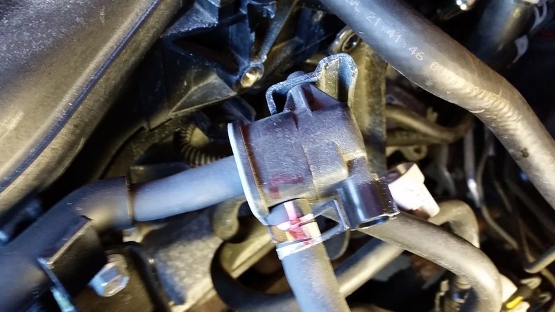

    On the drivers side, in addition to taking the grey electrical connector off, I found it helpful to also take out the 10mm bolt that holds this valve on. You can then move it out of the way to get a straight shot at that center plug:

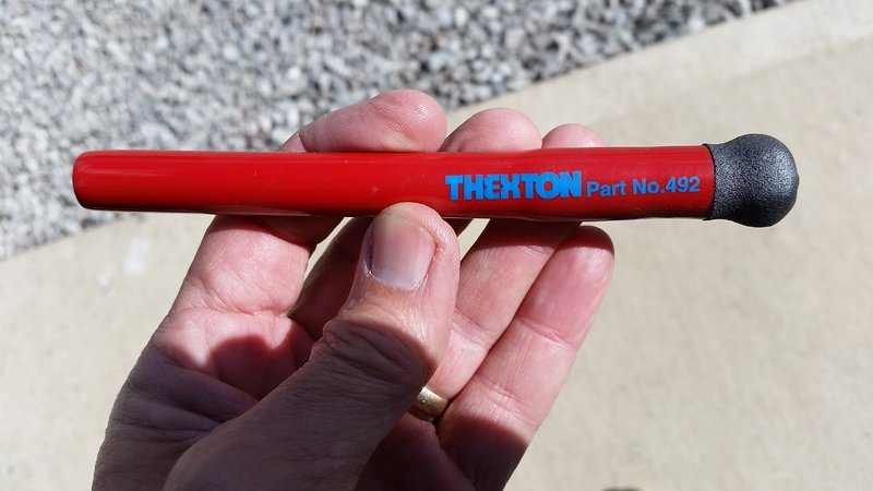

    I rounded up the plugs and all tools I would need far ahead of time. I already had all the sockets and extensions. As someone else posted, it is nice to have a 5/8 spark plug socket with one of those rubber things inside to grip the plug when you take it out AND another 5/8 spark plug socket without it so that when you install the plug, you can pull the socket and extension out without risk of the socket staying on the plug. I ordered the Denso plugs, anti-seize, and a Thexton spark plug tool from ebay. The Thexton spark plug tool is REALLY nice - I have used a hose in the past on other engines, but thought I would go first class this time. It really helps make sure you get the plug started in properly without any chance of getting it cross-threaded:
    I set the gap on the new plugs to .043". I can't tell any difference between how it runs with the old versus the new, but it is nice to have done the job myself. I know with 100% certainty it was done properly and very carefully. Something that you can never be sure of when someone else is doing the work.
