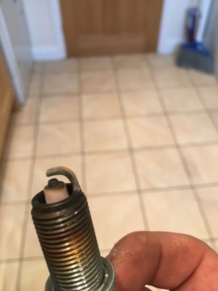

    Just got done with mine @ 31k miles. The denso plugs were all at .048 and the NGKs faired a little worse at .056-.059. Pic of the single plug is the worse NGK at .059.
    Gapped all new plugs to .038 and called it a day. Took about an hour and 15 to get it all done. Not too bad

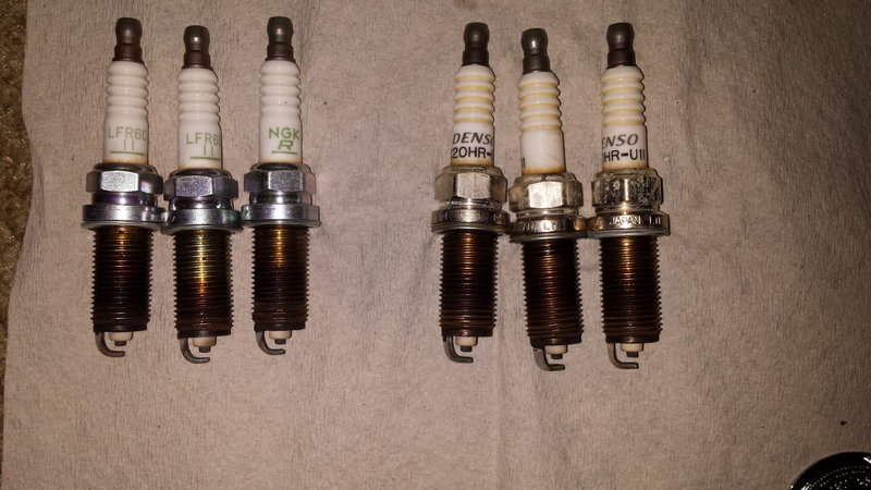

    Been getting shit for mileage, between 14.1 and 14.6 last three tanks, figured I'd change plugs and see if that was culprit.
    25,556 miles on them.
    NGK: .051, .057, .060
    DENSO: .043, .044, .045
    Replaced all with DENSO, $2.75ish each from local dealer. Great writeup, only took me 1.5 hrs. You don't need to take off any wires or hoses on driver side though, I took top bolt out of that black bar and loosened the bottom bolt to swing it out of the way. Used a 10" and a 6" extension together on driver side to make it easier.
    And yes I checked the "pre gapped" plugs before putting them in, all were at .040 minus one at .041
