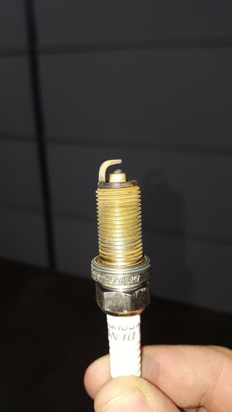

    First post. So I've got a 08 Pre-runner 2wd double cab that was my truck originally, then went to an employee of mine for a while. Now I've got it back for my soon to be 16 year old daughter to drive. Pray for me on that one.
    It has 191k on it and still drives great, still on the original plugs. Going to change them tonight. I was kinda surprised to see the recommendation of changing at 30k. That doesn't seem like very long life for a plug. I haven't driven this truck regularly for at least 5 years but after having it back for a week, I'm noticing that the gas mileage stinks big time. I'm guessing this has something to do with the plugs and probably dirty injectors. I'll post pics of the old plugs when I get it done and report on the old plug gap. Having the radiator flushed, hoses changed and refiled right now. Next up will be getting the transmission and rear end serviced.
    1Shifter and NAAC3TACO like this.
  12. Aug 4, 2016 at 5:47 PM
    #1772
    triplehorn
    triplehorn New Member
    Aug 4, 2016
    #193738
    4

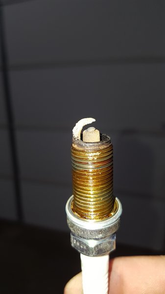

    Plug change done. First up here is one the factory Denso plugs after 191k miles.
    Next up is a factory NKG also 191k miles on this plug
    Gap on the Denso plugs were .061-.063, the gap on the NKG were .070-.072
    JMoney, 14489 and 1Shifter like this.

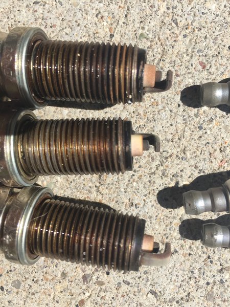

    Just did it in 2 hours. Plugs were toast at 37k. NGKs were way worse than the densos. One denso wasn't in as tight as it should have been for sure. Overall a very easy job with the right tools. No longer getting a shudder up to 20mph.
    Caprizzy likes this.

    I did mine a few weeks ago my NGKs were toast as well I have all Densos in now:thumbsup:
    diabetiktaco[QUOTED] likes this.

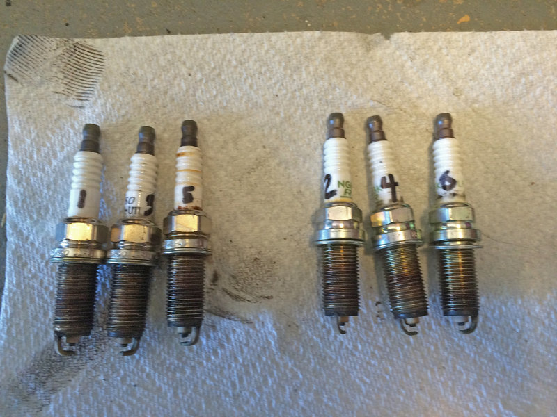

    Just did mine at 65K. Electrodes looked clean, the the gap was growing but wasn't beyond the 1.1mm max.
    They all broke free with a little effort but no hint of seizing. The ignition coil bolts were all super clean. Man, that #2 coil connector is a son-of-a-bitch to get on and off. The other 5, no problem.
    AFAIK these are the factory plugs, notice anything? The RH bank was Denso, the LH bank was NGK.

    Yes that's how Toyota did it something about wanting to make both of the manufactures happy. I thought the same thing when I pulled mine out.

    Reading more this is fairly common it sounds like. Camry owners talk about this, too. You'd think Toyota wouldn't have to do that with Denso since they're already part of the Toyota Group. I could see NGK wanting volumes used for pricing. Well, in any case, now I know the plugs were original.
