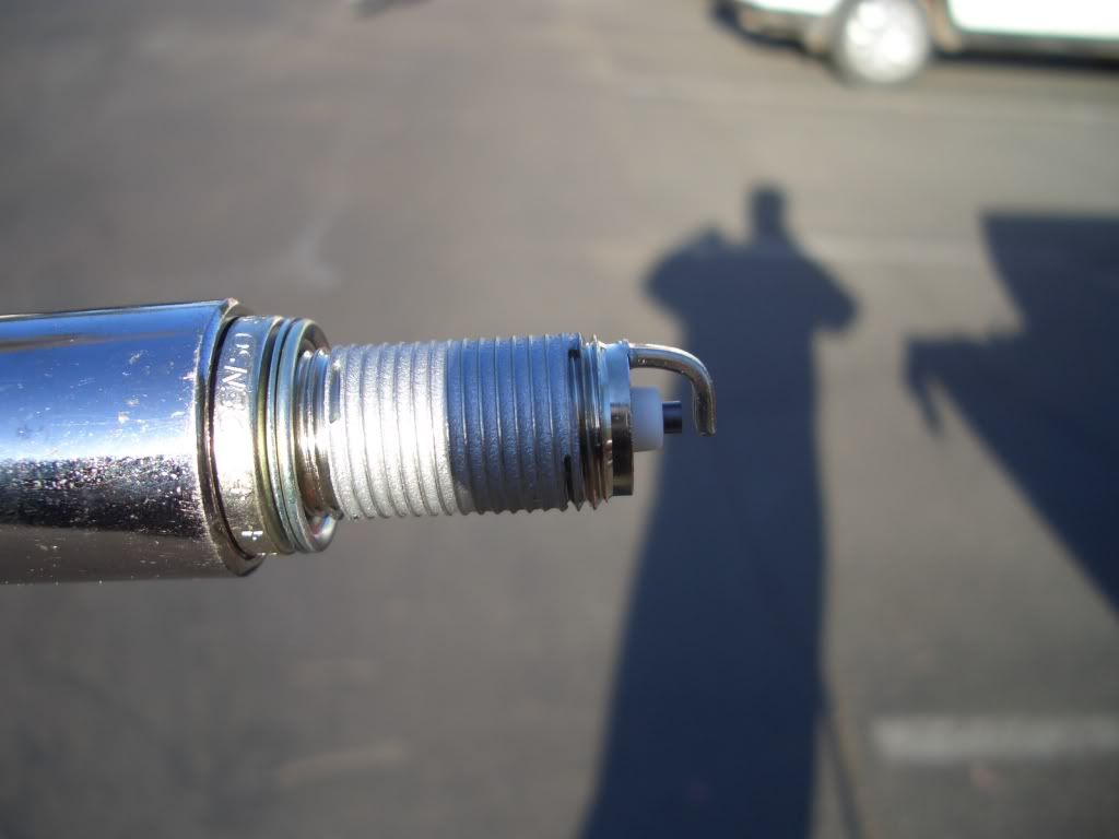

    Where does the anti-seize go? On the threads?
  5. Oct 20, 2009 at 4:44 PM
    #165
    chris4x4
    chris4x4 [OP] With sufficient thrust, pigs fly just fine. Moderator
    May 8, 2008
    #6497
    112,751,684
    FlimFlubberJAM
    Tenoe, AZ
    2019 Rubicon 4 Door,
    4.10 gears, sliders, and lots of buttons.
    Yes. Look at the pics, and you will see how there is a silver film on them.

    Do it just like the pic. Keep the anti sieze away from the end of the plug. :)

    Hi Chris,
    Nice write-up with lots of great pictures. Thanks for taking the time to put this together.
    I'm curious about one aspect of this. Is anti-seize recommended by Toyota?
    Also I would characterize what I see in the picture as a lot. Most of that - probably 99% - will be pushed out and form a ring around the base of the plug as you screw it in where it will do no good.
    If anti-seize is not specified by Toyota, be aware that it will affect the results of tightening to a specified torque. Because the anti-seize acts as a lubricant, the same torque results in greater tension on the threads.
    best,
    hank

    I have never had an issue with the amount of anti sieze I have used on the plugs. But you do have a good point, if too much is used. The owners manual dsent state to use anti sieze, but it is required.
