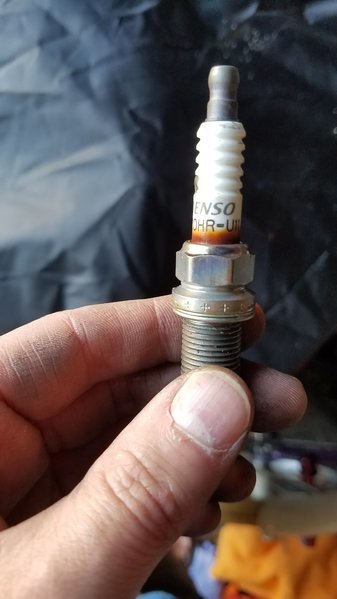

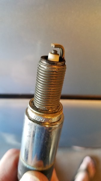

    I had an hour or so of free time today so I changed the passenger side plugs. They were done about 30k ago by me. They looked ok, the gaps were around .045 on the ones I removed.
    I also cleaned the MAF sensor and throttle body. Which was pretty easy.
    Tomorrow I'll change out the drivers side and PCV valve.
    One plug looked a little burned around the ceramic... is this normal?

    Are those the factory type? What grade and octane gas do you typically use? What torque did you use on the plugs and any anti-seize. That can happen when you burn lean but I don't think that's what's happened.
    That discoloration is probably a plug that's not torqued high enough into the cylinder head.
    https://www.volvoclub.org.uk/faq/EngineMechanical.html
    Scroll down to "What Happens When Plugs are Installed Incorrectly?" and you'll find the description for this image.
    I've always used copper anti-seize on my spark plugs (I'm paranoid) but any time you use thread compounds you have to adjust the torque if the spec is for dry threads. Sometimes torque specs are given with a thread compound, maybe anti-seize, maybe oil (such is sometimes the case with cylinder head bolts), etc.
    Anti-seize reduces the friction of the thread so I usually reduce the setting to 10% of the spec (or the lower one if two are given) to avoid over-torque. In this case the 1GR plugs should be torqued to 15 ft-lbs and I used 13. None of mine looked like but they were the factory set so no anti-seize.

    Yes I did use anti seize, you can actually see its still visible on the threads.
    I used Denso plugs from Toyota dealer.
    I run 87 octane gas.
    I am fairly certain I torqued then to 20ft lbs when I installed then. That said I have a 1/2" torque wrench and used a step down for my 3/8" drive spark plug socket on a long extension. Maybe that's the issue?

    Interesting.
    Looking again I do see the anti-seize. You definitely didn't under torque them.
    I don't think a 1/2"-3/8" adapter should have caused that much issue, although it's possible (I'm assuming) you were at the very low side of the setting on a 1/2" torque wrench which can be less accurate than right at the middle of the range. Even so you should still be fully seating the plug.
    I doubt you're running lean, but who knows.
    Let you know in a few thousand miles if mine look like that since I did pretty much the same as you. It will also be interesting to know if the left bank plugs look the same. Maybe it's the anti-seize blowing out or letting gas escape. That's a major stretch but I got nothing else.

    For reference it was the front passenger plug that had the ceramic discoloration

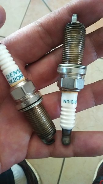

    i just changed my brothers factory spark plugs they looked the same

    Those are iridiums. I have cooper in mine
