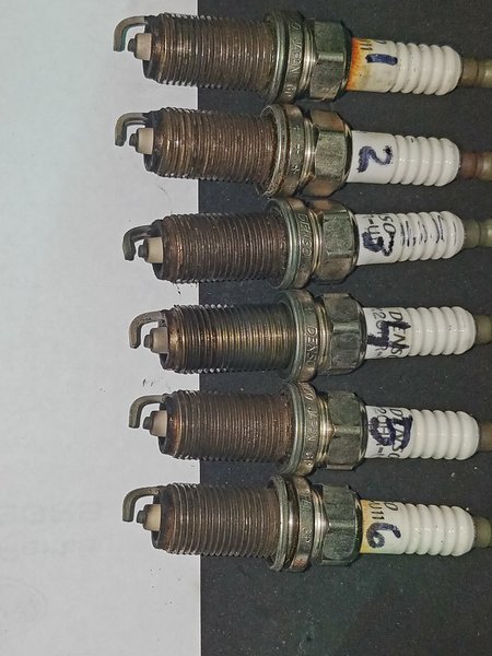

    Thanks Chris.
    Second time I've done this and got it down to about an hour or so. All 50 thou after 40,000 miles
