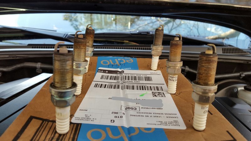

    Bought an '05 TRD Sport access cab (6-speed manual with only 92k) less than a month ago - I pulled the #1 coil and plug, it was pretty worn and NGK - the PO was very easy on the truck, but not a DIY kind of guy. So I ordered the stock Denso plugs on Amazon for $4.02/each, changed them today. Old NGK gaps were #1-.068, #3-.070, #5-.068, old Denso gaps were #2-.066, #4-.066, #6-.062. Consistent wear, and not bad for 92,535 miles on the original set. According to my calculations, the wear was about .0029 per 1000 miles, which is quite a bit higher than the the OP has listed on page 1 (0.00063~0.000126 inches/1,000 miles). The new copper plugs came from Dan Deery Toyota in Cedar Falls IA, in OEM Toyota boxes, and were all pre-gapped at .043, which is where I left them. Install was easy (yes, I used anti-seize) - the one that gave me the hardest time was #2, drivers side at the front, only because the electrical connector for the coil is so tight on the harness, there's not enough slack in the wire to just pull it off and slip it on. I ended up pulling and turning the coil at the same time to remove it, which wasn't bad, but putting it back on was a PITA! I finally did the same thing, holding the coil in my right hand, connector in my left, and starting it on then rotating it slowly and carefully so it lined up and popped on. I've only put gas in once since filling it up when I bought it, and got 14.5mpg in around town driving, plus I was still getting used to the truck and the transmission. Hopefully, the plugs will help. The truck started up, running smooth.

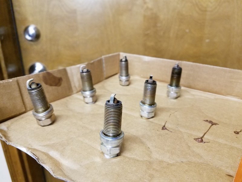

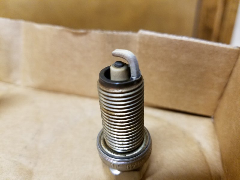

    Finally got around to doing this today and I ended up with a couple questions. My truck has 160k on it now, and I've had it since 135k with no maintenence records. If I still have the Denso/NKG plug combo, is it likely I still have all of the original plugs? They all look pretty clean to me, with the only rougher looking one being the drivers side/closest to the cab one. What do ya'll think of how they look? The individual plug pic is representative of 5 of the 6.

    They look cleaner than mine as far as your threads but the gaps on yours look pretty far out of spec. Could just be the angle though.
