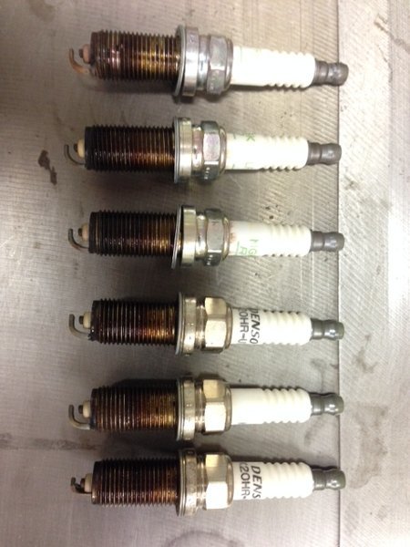

    Finally got around to changing my plugs at 75k miles....and what a difference. The Denso plugs had eroded to .050, but the NGK plugs were at .060+. Trucks accelerates and runs much smoother. Took 2 hours as reported, most of that on the drivers side...:thumbsup:

    does turning tires to black wall out count? How bout added snug top rebel.
    Denso were definitely in better shape in my truck also. Glad I replaced all of them with Denso!

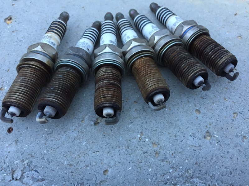

    So, today I went to all the local parts houses asking for plugs for my truck and telling them I wanted the NGK's (I am an NGK man), and all of them tell me that the OEM plug is a platinum, I didn't even bother getting into an argument with any of them, most have never been under a hood anyhow. So no one had the plugs I wanted, they had to order them, picked them up this afternoon and forgot to buy a long pair of needle nose. Wouldn't ya know, one of my boots stayed on the plug, SMH! Anyhow, I found that the P.O. Had put motorcraft platinums in it, . These things looked worn out, what do y'all think?IMG_3499.jpgIMG_3498.jpg
    At least nothing was fouled or not burning, all look the same. Im shocked how white the porcelain is, usually when I see plugs that clean its after a nitrous pass at the track.
