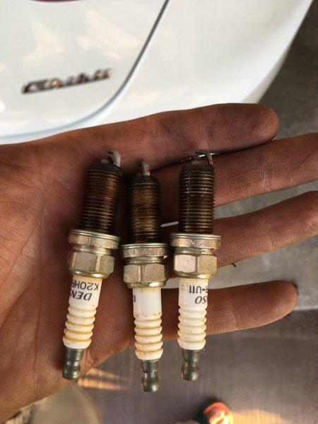

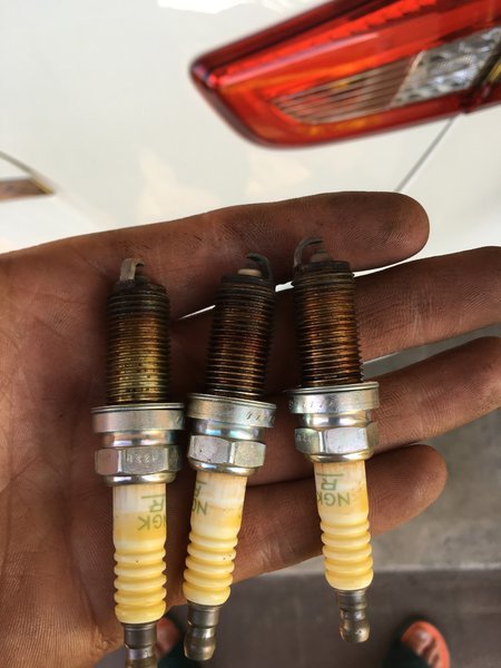

    Just bought a 2010 Toyota Tacoma Prerunner dual cab with 100k miles in it, since i have no idea when the spark plug was replaced so Ive decided to just change it.
    Did some research about having 2 different brand spark plugs and they said that it was actually done by Toyota factory. If this was the original plugs I think it was
    pretty amazing that the old spark plugs was actually not that bad as far as the engine was running. But I only noticed the some difference when I test drove the truck with a set of NGK iridium plugs gapped at .041, the engine is more responsive, it accelerate better. heres a picture of my old plugs, by the way old plugs gaps have expanded to .050 + the old plugs are denso and ngk,
    1 type each bank.
