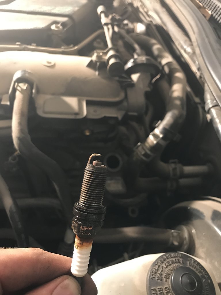

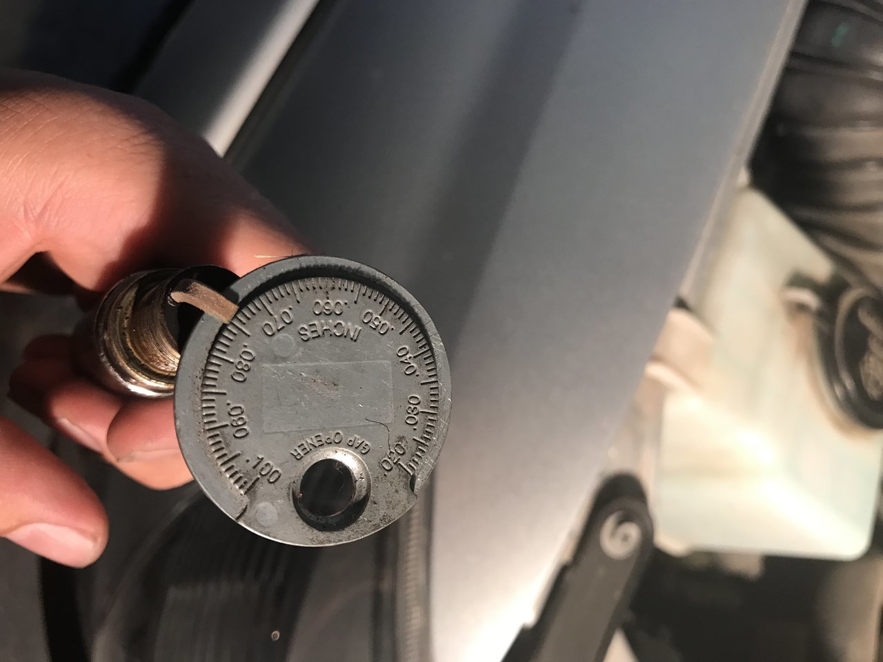

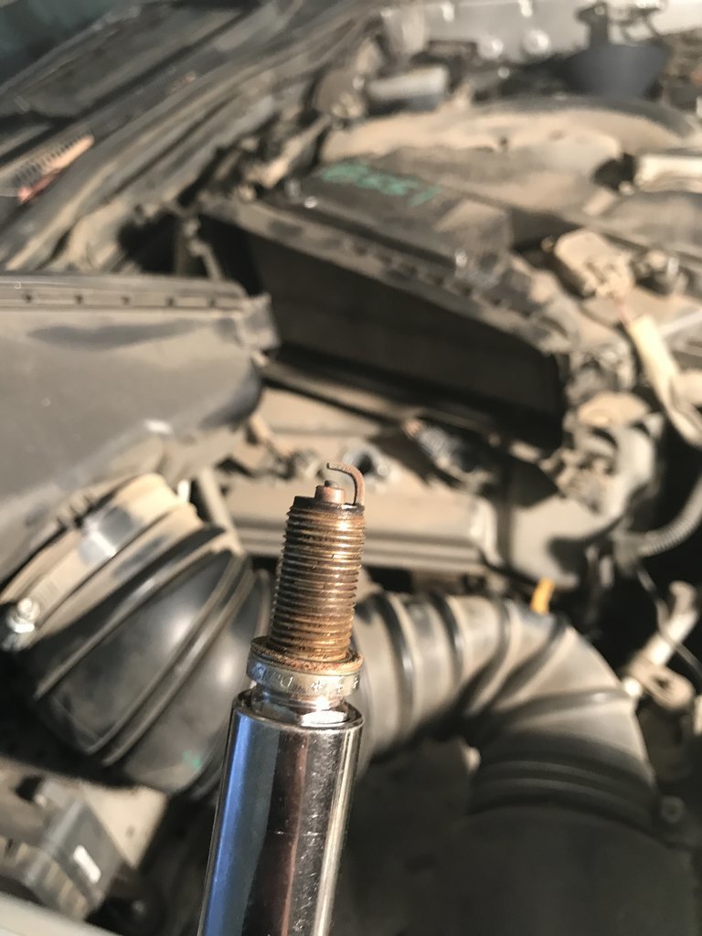

    CHanged my plugs today.
    Were all .070-.080 gap....
    #5 had this gooey crap.
    They were all almost seized and rusted
