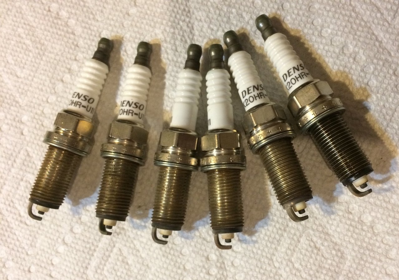

    I had some free time tonight, so I decided to go ahead and get it done. Thanks to the great photos and write-up, and the extended swivel socket for the spark plugs, it went very smoothly. It took about 1.5 hrs working carefully. Better than I anticipated for the first time doing myself. It feels great to save $250! Thank you everyone for sharing your knowledge on here.
    Old plugs had been in for about 45,000 miles. They didn't look too bad though.

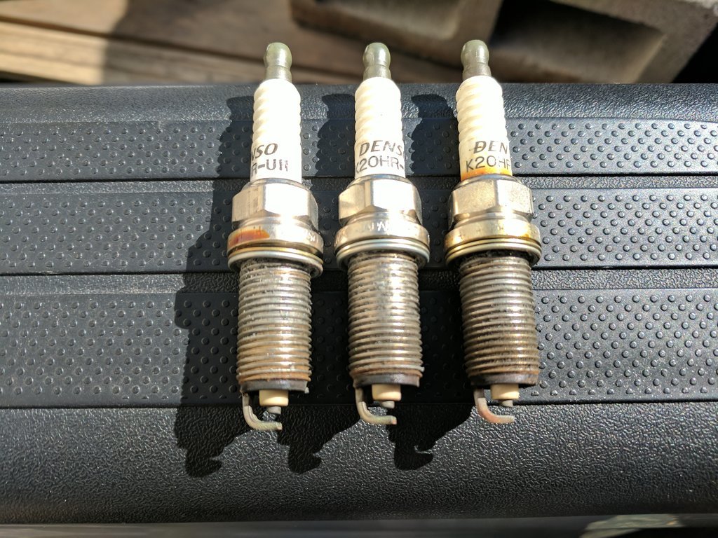

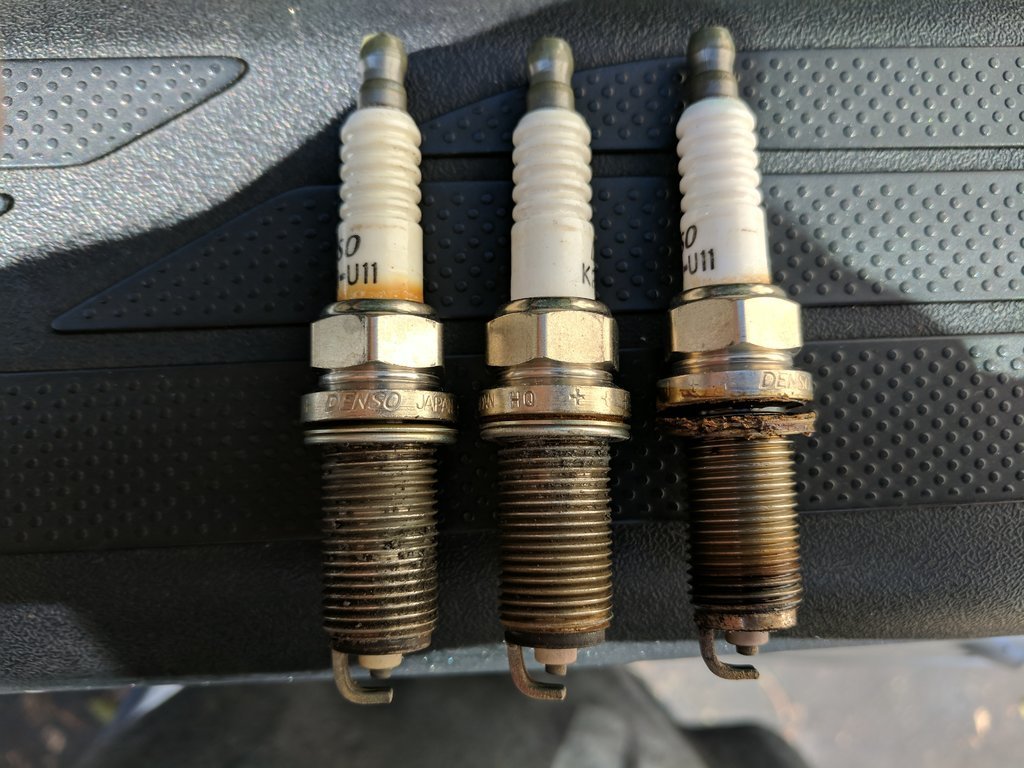

    Changed my plugs again. These probably have about 35k on them.
    Passenger side
    Driver's side
    The one on the right looks to be in rough shape. It was the one closest to the firewall.

    That one doesn't look good at all. What is going on with it? o_O

    It came out the easiest, so maybe I didn't tighten it enough when I put it in? Didn't cause any problems though.

    Drivers side closest to firewall always looks worse than the others on these engines. I wouldn't worry about it.

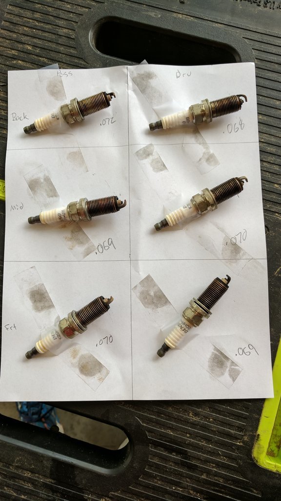

    The plugs in the truck - all 6 were the Densos, so it had plugs done at some point in its life. Every old plug I pulled out was gapped between .068 - .072 - assuming due to wear? The elctrodes were worn at an angle too, so the effective gap is bigger than what the gauge can read. None had any suspect signs of weird engine conditions. Driver's front coil was a true PITA to get disconnected - a hook tool and flat screwdriver helped release the clip.
