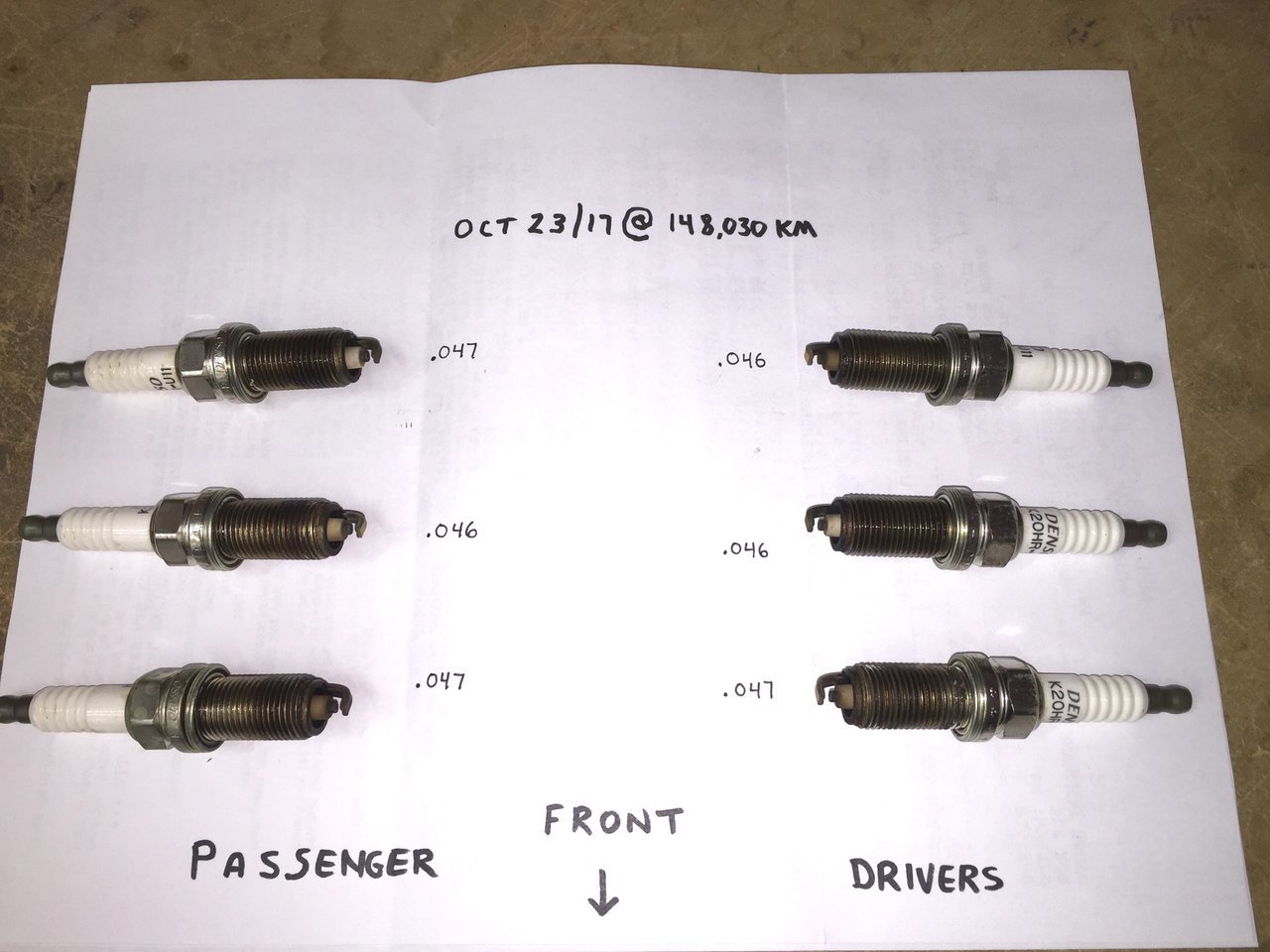

    Those are totally the wrong plugs for the Tacoma. There is even a big warning sticker on the drivers side valve cover to install the long thread plugs.

    I purchased my truck about 6 months ago and no record when the previous owner changed them. Judging by the consistent gap and overall good shape, they probably don't have many km's on them. I changed them anyways so I know exactly how many are on them now.

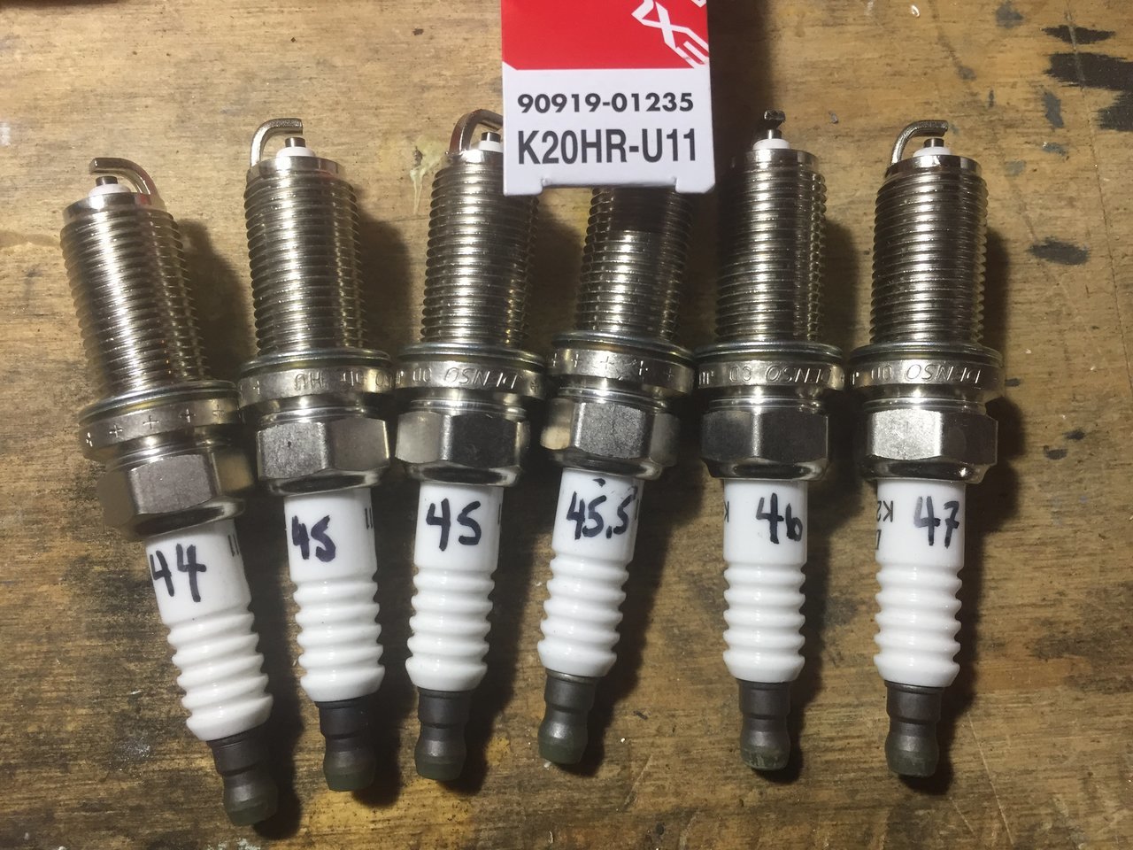

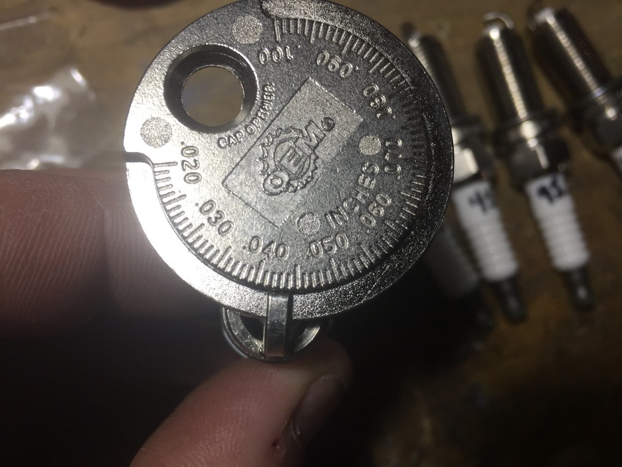

    How would you guys read this gap? I see 0.044 as that is where the leading edge stops.
    If that's the case then here are the plugs (and gaps) I just picked up from a dealership.
    I'm going to call them tomorrow to double check if they are supposed to come pre-gapped
    Plug change coming up this week.

    Just finished this! Write up was spot on. I have a TRD offroad, so I have to move a pump on the passenger side to access the intake bolts. Serial numbers were perfect and they came from the dealership “pre gapped”. Not sure if this is on purpose or just luck. Took me just inside of 2 hours, even with cleaning my K&N filter and cleaning the MAF sensor. The old ones were in rough shape....

    Flying_taco...did you check the gaps yourself?
    See my post above yours.

    I ended up using a feeler gauge to set the new plug gaps at 0.040. They were way off from the dealer.

    Yeah, I just picked up the coin type gauge to double check. Mine were .040-.043, good enough for me

    Just curious where the range for the spark plug gap in the original post came from
    In my owners manual and in the Haynes manual they both say .043 without any ranges at all

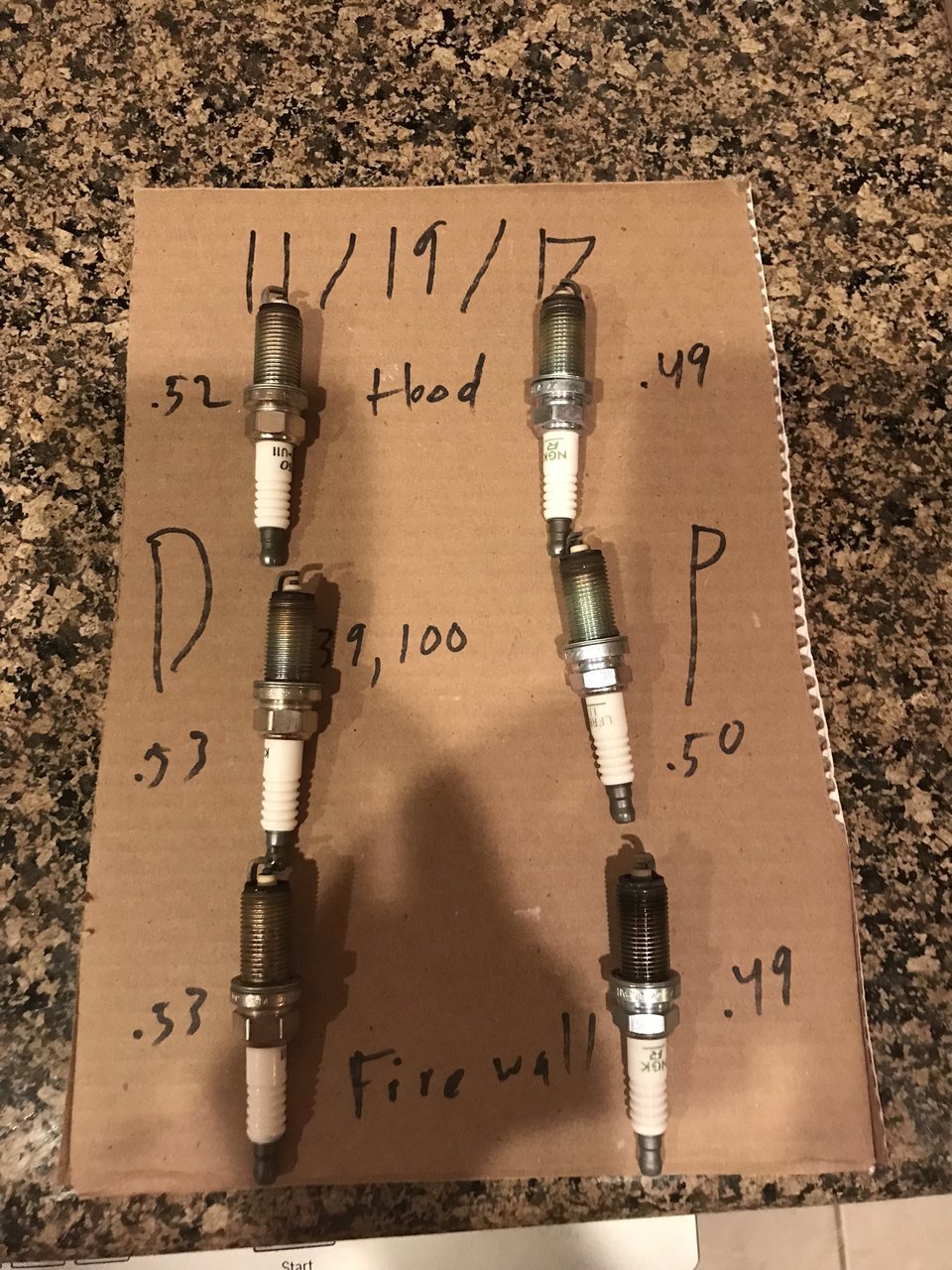

    Did my plugs today. Truck was at 39,100 miles and replaced all the plugs with Denso K20HR-U11 and gapped them at .43 thanks for the write up and the tip to use the Gear wrench swivel spark definitely made the job easier. Toyota really torque those spark plugs. I was a little worried that I was going to damage a spark plug. Man, those coil packs also were a pain! I ended up using pliers to remove the coil pack and that made my fingers happy. Here is a bad pic of my plugs. I definitely think the Denso were the better one to go with since then glad are so dark.

    That dark thread plug looks like the one I just pulled from my drivers side firewall. I wonder if oil is getting by the valve cover o-ring.

    Props to OP writeup i followed it as a noob and did great, i HATE the coin type thing tho mine seemed to suck ass
