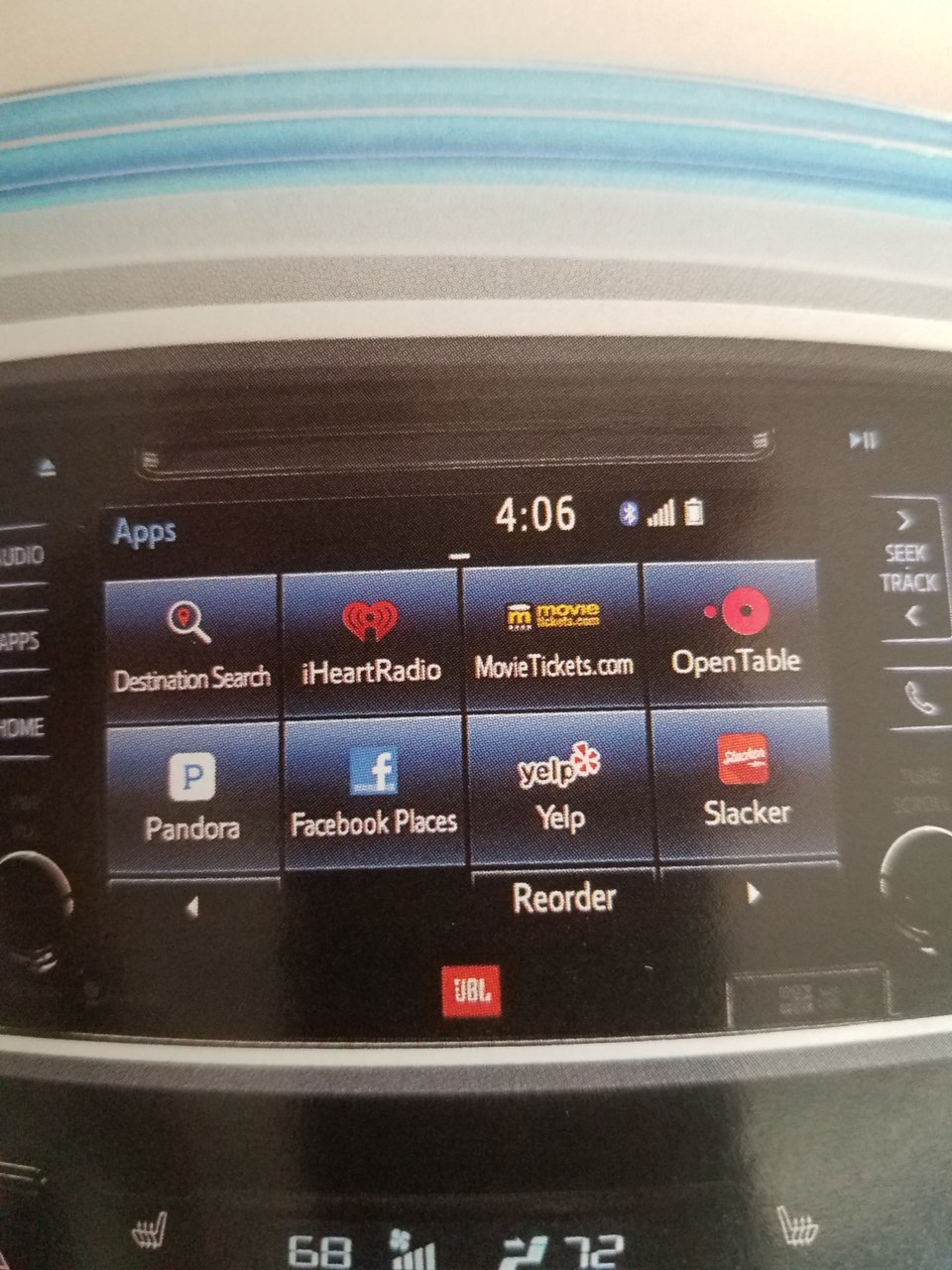

    You would have to look at the radio to see if it says JBL on it.

    15360004870359106879497688994158.jpg If I am not mistaken it will have that red JBL on it.

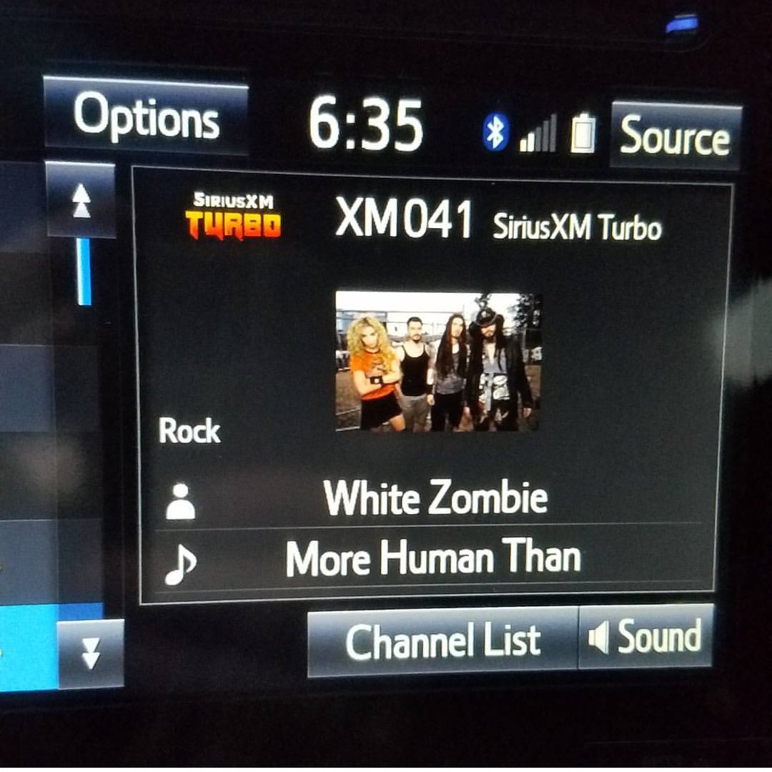

    Scrolling thru my old pictures and in guessing no, but this is the only picture I have of the radio. I might have cropped off the JBL logo.20180903_221129.jpg

    There was a Premium & Tech package with JBL and a Premium & Tech package w/o JBL. It would be listed with the P&T package on your sheet. Since yours doesn't have it, I'd say no you don't have JBL.
