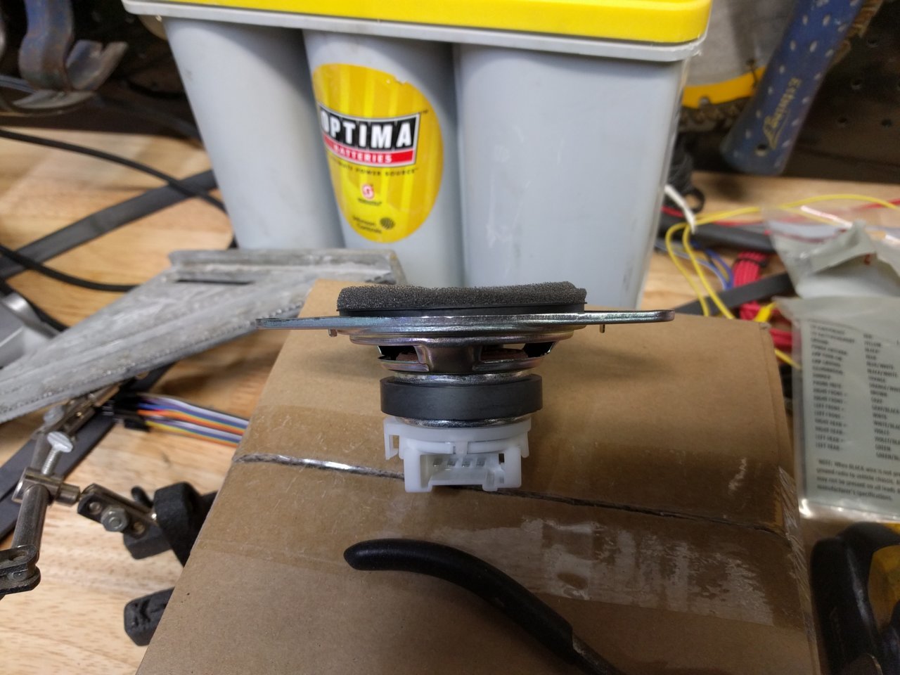

    might be a stupid question- but why use parts (Tweeter) from a Subaru?

    They are a direct plug and play and superior to the stock tweeters.

    So no aftermarket company makes a better plug and play tweeter? We're pirating old Subaru stuff?

    Better options sure but plug n play is popular as not everyone is an educated audiophile and a plug and play upgrade is nice to have. Quick, easy, and makes a good difference. Those are signature traits of a good mod. Kind of like the unifilter mod or the diff breather mod but even those are more complicated than the tweeter upgrade.

    Any chance you know or are able to find out the part number for the male end to those factory tweeters?

    Well Crutchfield is pretty good but they will try to sell you some expensive component speakers instead. They’re wrong. The Subaru kickers will work very well.

    I didnt do it and crutch sent me a component set. I had to fabricate a new bracket from "universal" back strap. It was a pain.

    Did you try salvaging the mount for the factory speaker. I’ve heard of guys tearing the speaker out of the bracket and attaching the tweeter to it.

    I tried. It's all fused together pretty tight. I even took after it with a hammer.

    Heh, that ^ was my plan for today...check out how hard it would be to pop out the factory tweet from the mount. It doesn't appear to come apart that I can see. I see lots of vendors selling plastic adapters that mount using the existing points. I'm just going to roll my own from some scrap plastic/aluminum from work I think. I did not see any 3d plans on thingverse either.

    was the Kicker on the doors as a the tweeters? Plug n play?

    Not by themselves, but Crutchfield included all adapters I needed to make them Plug n Play (wiring adapter, speaker mounts, etc).
