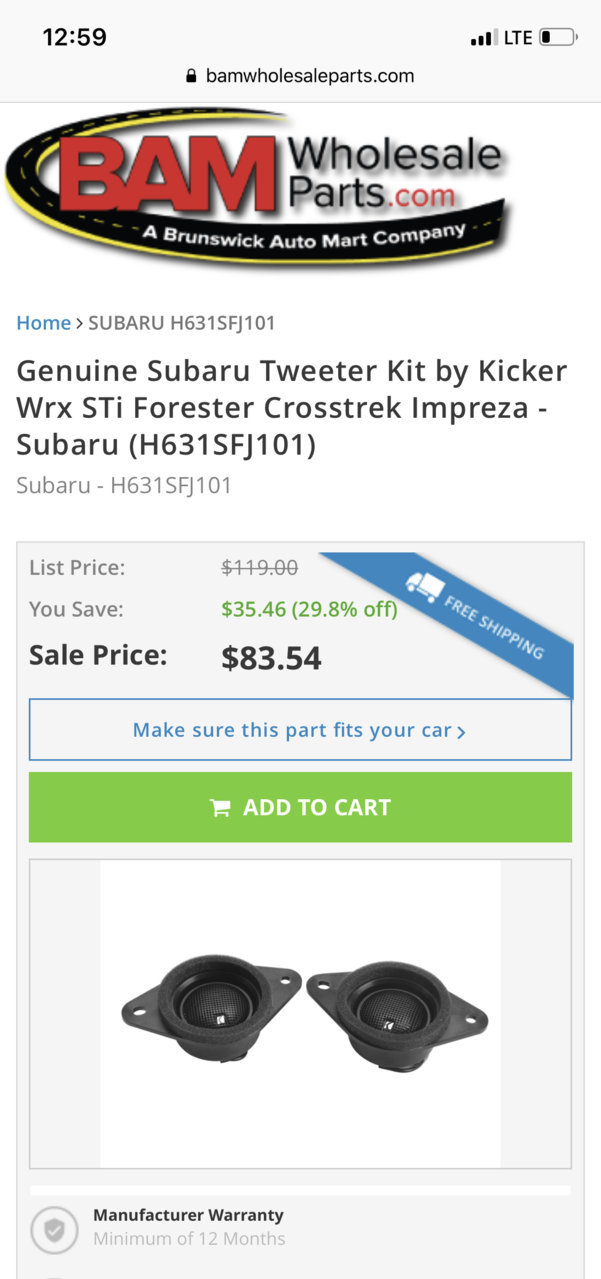

    Found them for 83 bucks shipped. Buy me a beer later.
    Bam auto has them. Won’t let me post a link.

    Here is a screen shot

    Wow, what a deal! I just pulled the trigger on a pair. I owe you a cold one!
