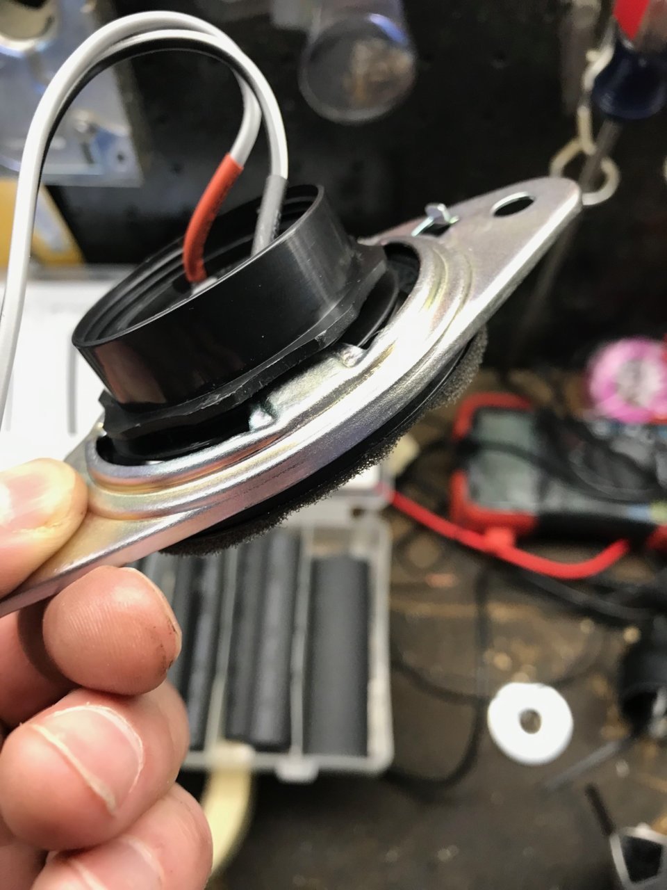

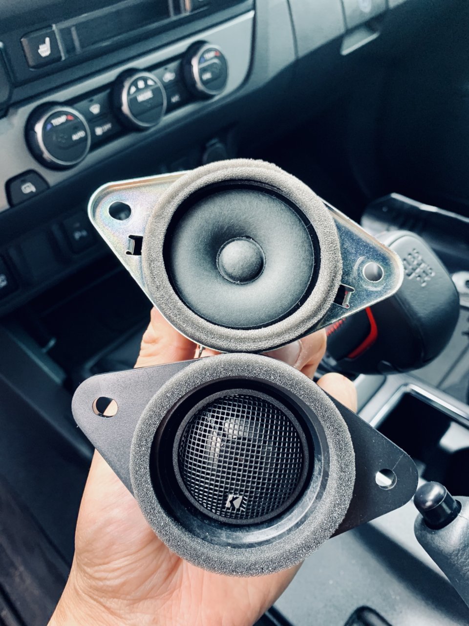

    Mainly because I'm cheap but also because I like to tinker I made my own mounts. I cut the three mounts that hold the magnet and voice coil as close to the magnet as I could. Bent those up and they held my new Kicker tweeter perfect.
    Was able to bend them tight against the tweeter housing then run the nut on base up to hold them even tighter. I also took the stock plug off the stock tweeter and added it the kicker wiring so no cutting of the factory wiring. Cost me 30 bucks and about an hour of time. Huge sound difference.
