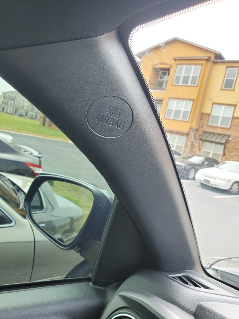

    Noob question...but how do I get the A frame panels off? Will it affect the SRS Airbag? In the guide, there is a bolt to just take out...but I dont have that. If I do...I dont know where it's at. I bought the tweeters to upgrade...just not sure how to get everything off.15861142443852597811008218516971.jpg

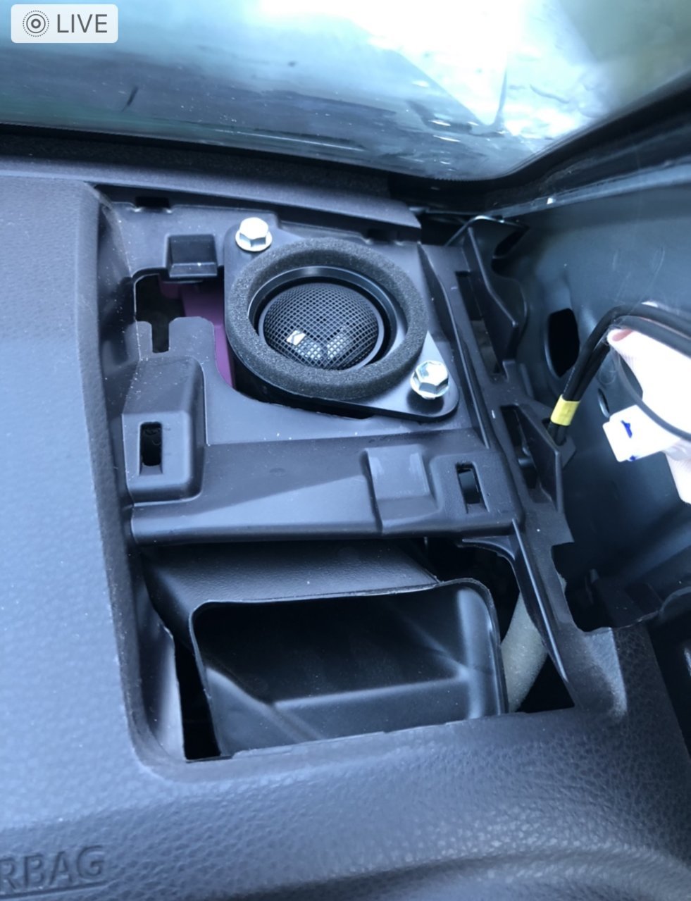

    Just did mine! Sounds great so far. But I also found out the specs on the kicker tweeters. 150 watt RMS for those little guys! Definitely needs power to really shine.

    Some people disagree with me for whatever reason, but I would also recommend disconnecting your battery before messing with your Airbag.

    When I did mine, I didn't disconnect the battery. If you wanna be 100% safe you can.

    Highly recommended that you disconnect the battery. A surprise deploy will ruin your day.

    It's not like it's super difficult or anything either... Why risk breaking your face lol

    Add another formerly skeptical now impressed Tacoma driver... best $94 I have spent on sound, ever... Those saying there was no difference for them check your work, you forgot to plug the new subie tweeters in; plain and simple.
    My unsolicited 2c--For those who are audio hobbyists: skip this mod. You are going to change the rest of your system anyway so don't waste money on stuff that is coming back out later. For those who want to take their stock systems from terrible to livable this may be the only mod you need.

    Wow!!! Just put mine in today HUGE difference from the stock tweeters. Now I want front and rear door speakers

    Do you really have to pull the A pillar or can you just pop the dash piece off?
  17. Dec 15, 2020 at 7:37 AM
    #697
    Tacospike
    Nov 19, 2018
    #273198
    14,419
    512
    Two Trucks
    I think most people have. I have seen some who haven't and just popped it out? I removed mine, it's an extra minute to do so.
