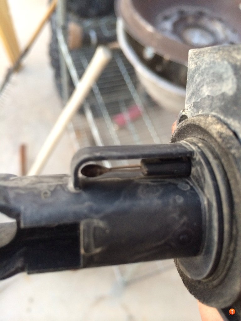

    Kind of random, but does anyone know how to tell if the MAF sensor is bad?
    I just went to clean mine and it looks kind of black. umujysan_f219bae186bba1a47a6c0aed32cb425f947c2c7d.jpg

    Did you spray it with MAF cleaner? If you did, did it clean up or stay like that? It should be relatively shiny.

    Yep. This was right after I sprayed it with cleaner.
    Whellllpppp. Time for a new one! Lol

    In the pic it's hard to see, but I meant is the sensor shiny? The bulb at the end is designed to be darker than the stem, black or dark brown. I guess I should have said was does it look dull like coated in dust or oily dirt? If it's shiny black bulb and shiny metal stem, you are ok. Unless you suddenly get shitty mileage or your truck sucks at acceleration or you throw a code, I wouldn't replace it.

    I believe it's shot. It didn't seem to have any shine to any part of it. I do feel like my truck is extremely sluggish, and gets shit gas milage. But I also have 35's, 4.56 gears, long travel and fenders that are like parachutes. :eek:

    MAF won't fix you mileage with that setup. Don't waste your money replacing it, if it isn't throwing a code then the maf should be fine. As long as you didn't break the thin wires inside it. Don't worry too much about how clean it is. The clean throttle body will make the most difference.
