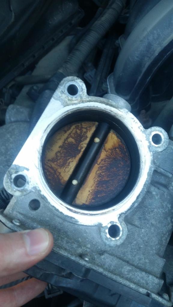

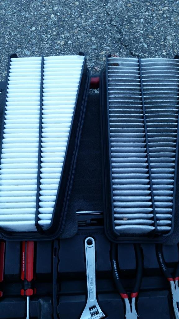

    Got around to it tonight, dang definitely needed to be cleaned. Will see how she drives tomorrow, too many beers in me to take her out now.
    Also did the air filter while I was in there, don't forget it!

    That's what mine looked like ^^^^ but a little worse hahaha, previous owner didn't do it. Most people don't, that's why this forum is great. Makes me aware of maintenance that most overlook

    206,000 miles, i'm still waiting for the RPM's to settle back down. 2k on start-up and hovers right near 1.4k idle.

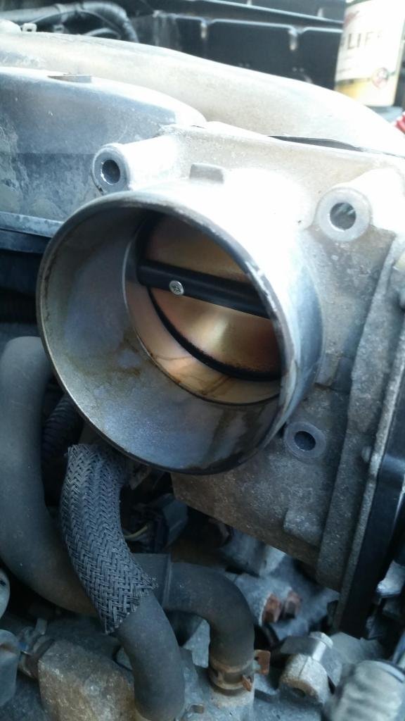

    For anyone that has notorious bad luck like me, and are worried about manually opening the butterfly... I did mine slightly different:
    I followed the OP up to the point of opening the butterfly. Instead I just sprayed cleaner on the intake side and cleaned as good as possible. I then removed the TB via the OP instructions.....

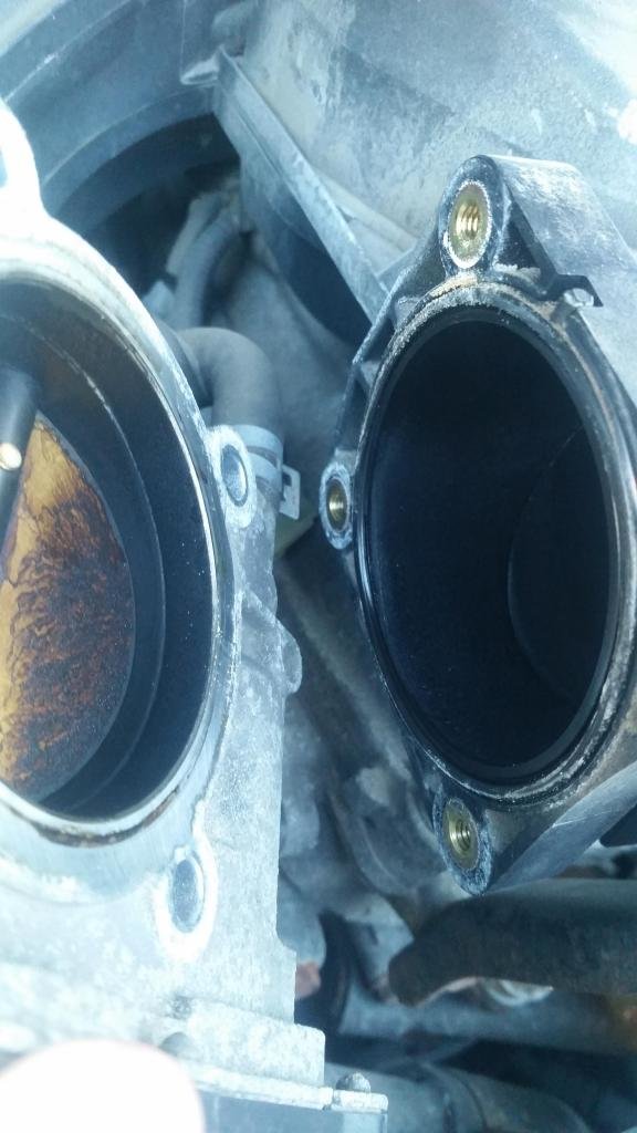

    This made me realize I had never truly seen the color black before.... Yikes. Anyways, I sprayed and cleaned the engine side as good as possible. I then bolted the TB back on and reconnected the battery. I had my assistant get in the truck and open the butterfly via the gas pedal (ignition on but NOT running). With the butterfly open I could then reach the small places i couldn't reach with the butterfly closed. Once done, reassemble and enjoy!
