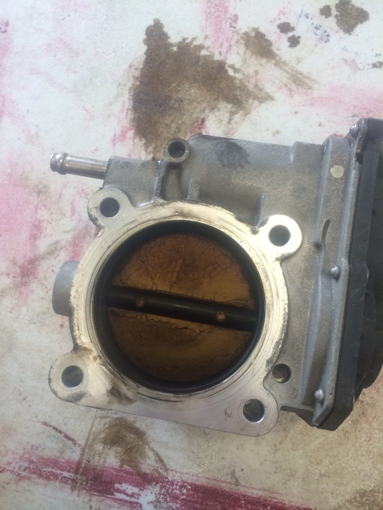

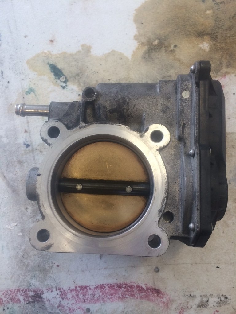

    331
    Cleaned the TB at 100k miles. WOW.
    Before:
    After:
  14. Jul 28, 2015 at 8:30 PM
