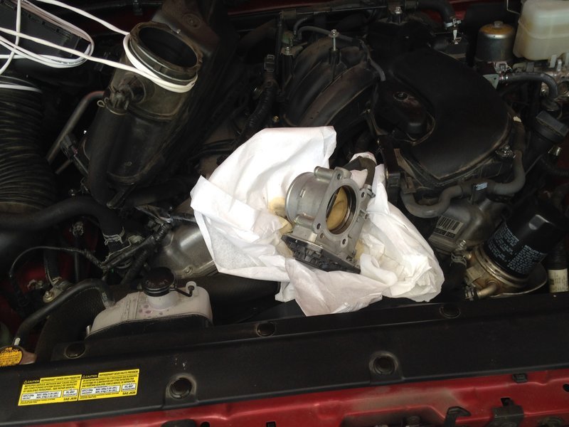

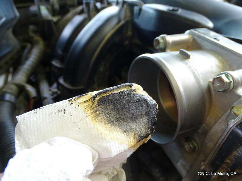

    Ok just tackled this job. Followed the OPs directions to the T. Total time was about 2 hours, with 30 minutes devoted to cleaning up the driveway. Went through an entire can of throttle body cleaner. What an abomination! Holy shit was it dirty. No wonder it felt sluggish. Getting ready to take it out now and run it good. Did plugs as well is also why it took so long. Started right up. No high idle, no smoke, nothing. Good times folks. OP the next round is on me! Cheers.

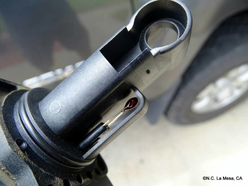

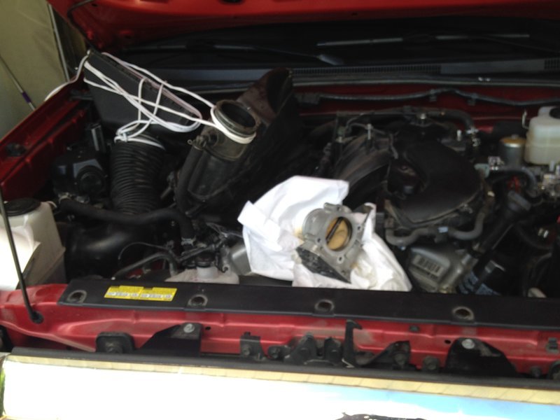

    I cleaned the throttle body today and took the mas sensor out and cleaned it as well. I'm assuming it was the 1st time it had been done and was about as dirty as I expected. The truck may be responding to quick accelerations a little better but it's probably in my head.
    The front
    The back
    Opened up

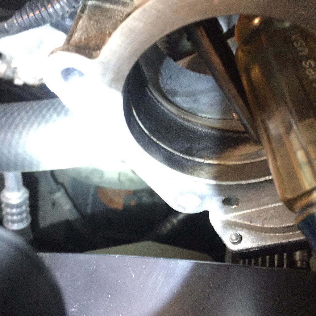

    I didn't removed it from the truck, just unbolted it and cleaned front and back. I wasn't sure how much if any coolant I would lose, and never read how you all dealt with that portion of the project. Being this easy I might remove it all the way if someone reports back.
    High idle- had it around 15-1700 as others reported. Truck coughed a little on start up. Let it run about 10 minutes drove out the road and noticed the idle would jump to around 2 when I let of the gas or let off the clutch.
    Parked the truck and started about 10 minutes later. No high idle, matter of fact the idle dropped to around 5-6. Maybe from cleaning? Short drive I did I seemed to notice a difference.

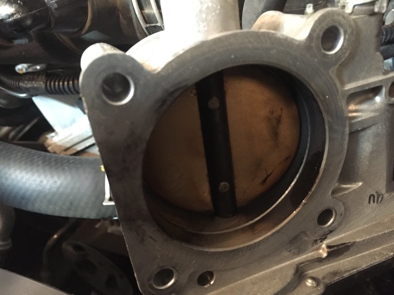

    Just took mine off for the first time after 160 thousand of oiled filters. There wasn't a ton of "gunk" but there was a layer of carbon that needed to be scrubbed heavily. I didn't think it was going to be a huge difference because I was in visioning sludgy stuff, but after looking at your guys' before and after shots I realized how bad mine was. It cleaned it out so much it idled warm at 2k RPMs. After an ECU reset tphrottle response has improved ten fold. Like a whole new truck. Thanks for such a good write up! Huge help!

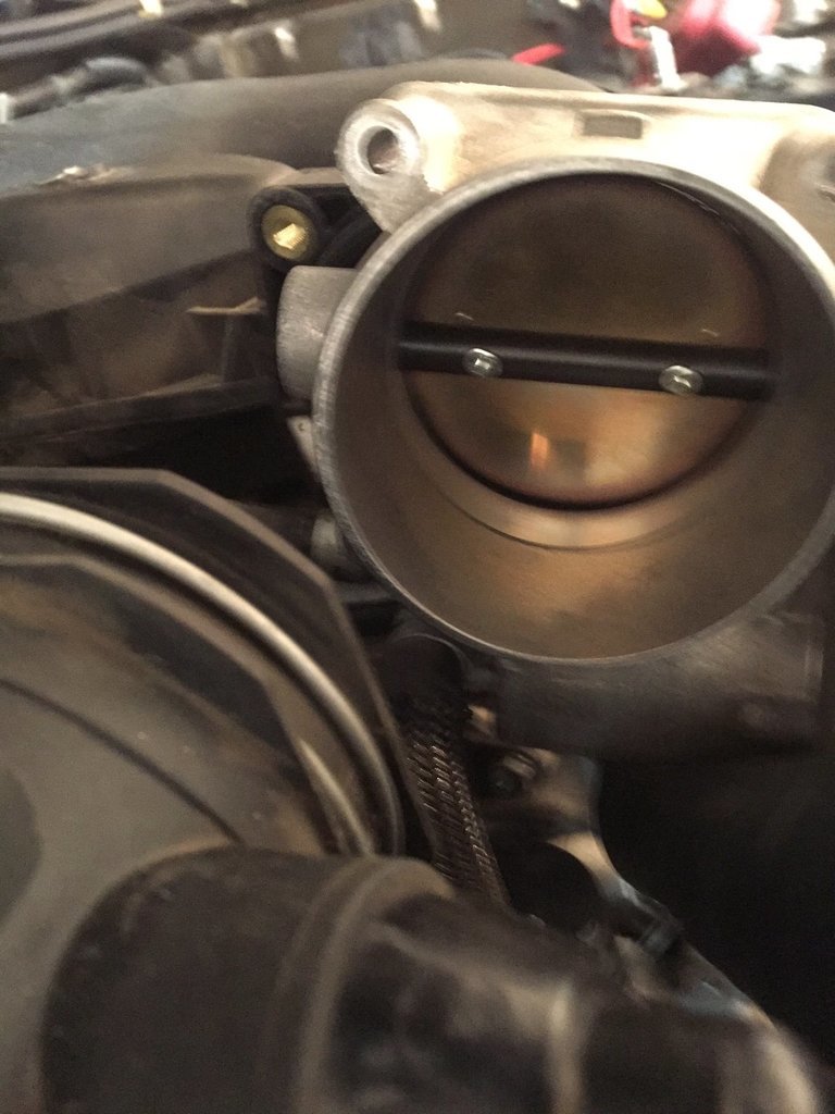

    Thanks for the write up. Hit 60K miles this month, and decided to tackle this. I've been following the maintenance threads since the free oil changes ended from the dealership. Did it all this weekend, oil, diffs, plugs, (dealership did brake fluid), and TB/MAF cleaning. I think I will clean the MAF during oil changes from now on, and the TB every other oil change. Literally takes 30 min. You can purchase a MAF cleaner, and TB cleaner from Walmart for $7. If you waited until 120K miles to do this then buy another TB cleaner too. I used almost all of the TB cleaner at 60K miles. Spray the MAF cleaner liberally, and it's removal is simple. watch out for the electrical connectors. Which brings up a question, anyone use dielectric grease on any of the electrical connectors? I've seen some videos of people doing that.
    I had already sprayed it a few times before I remembered to take a photo. It was dirtier, but around the hinges is where I made my money cleaning.
