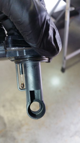

    MAF Sensor Cleaning Erata

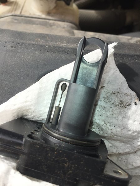

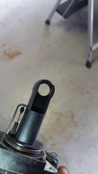

    There is one change I suggest to this threads instructions. To fully clean the MAF; the MAF needs to be pulled from the intake housing. This is because if you leave the MAF in the intake housing, you can only clean (what looks like), the thermistor. The round bulb on the two wires seen below.
    The MAF needs to be pulled so you can spray (clean) the "wires" in the tube. It can only be accessed from the top. See the two silver/gray out of focus wires in the tube.
    MrKatanga likes this.

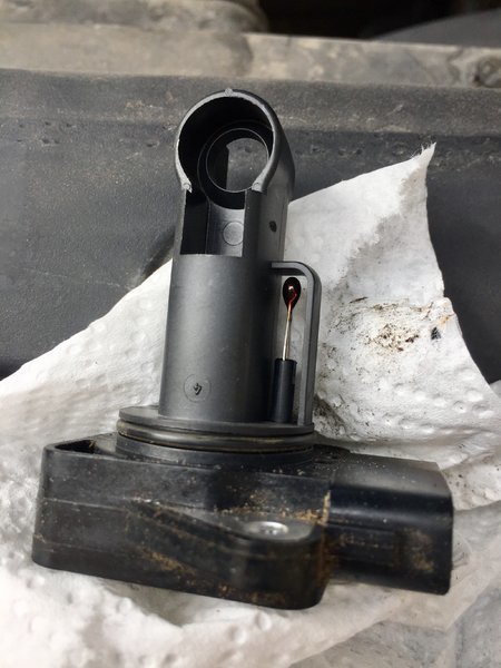

    I thought for sure the MAF would be all kinds of dirty so I was disappointed when I first pulled it and saw the bulb was perfectly clean. Then I turned it over and bam, smudge covering the other half of the bulb!
    The truck has great throttle response now and will spin the tires again without trying. 172k miles, living in the desert and first time cleaning it so you can imagine how sluggish it's been. Feels like it regained 25hp and low end tq.
    If you choose to leave the MAF in and spray inside the housing from the TB side, you may not be able to fully clean the bulb. The dirty side was the air filter side as that's where the air comes in. I'd also recommend getting a new o-ring as mine expanded after cleaning.

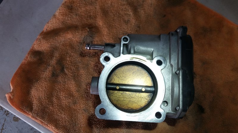

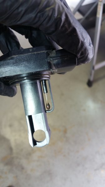

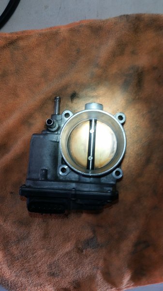

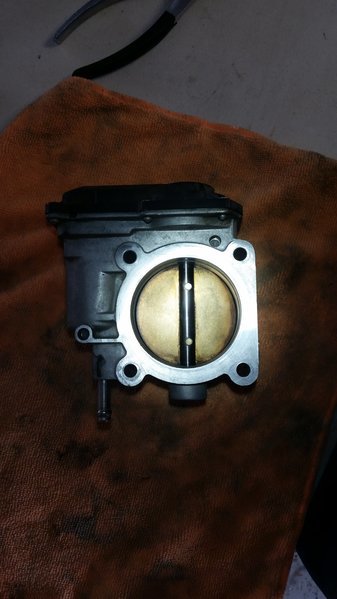

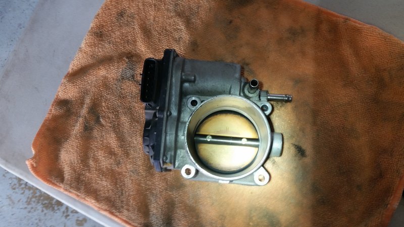

    The steps were super easy to follow. I completely removed my mass air flow sensor and the throttle body and cleaned them that way. Like other people, my sensor was dirty on one side and clean on the other. I wouldn't be able to get the dirty side without completely removing it. After i was done the truck idled really high. Then the idle would bounce around after a couple miles. By 5 miles everything settled down and the rim was back to normal.
    Before
    After

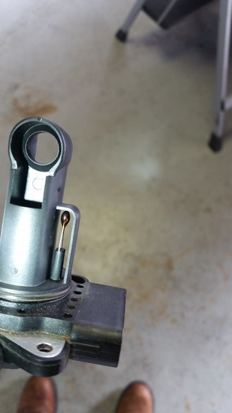

    Good info and pics. I removed the MAF to clean it. Can't clean the dirty side otherwise. Next time I will remove the throttle body to clean it for the same reason. I'm sure it will be just as easy, will end up cleaner, and no cleaner into the intake. :thumbsup:
