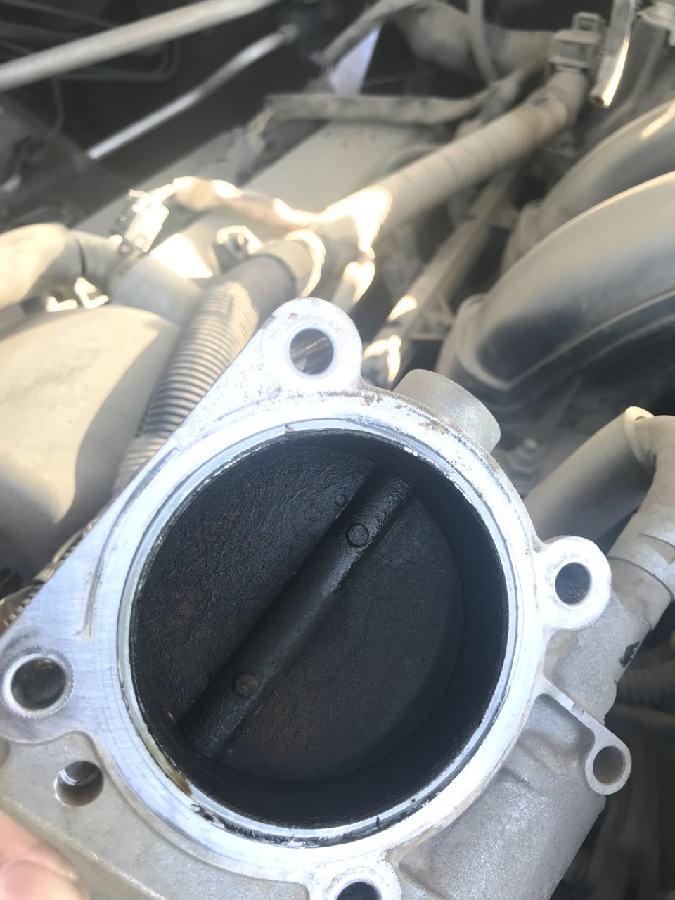

    I just cleaned mine at 122k and it was really black. After cleaning it I had CEL on but a quick reset and it was fine. I definitely noticed a smoother drive. I took throttle body off to do it. Much easier. I didn't do the MAF as I didn't have any cleaner

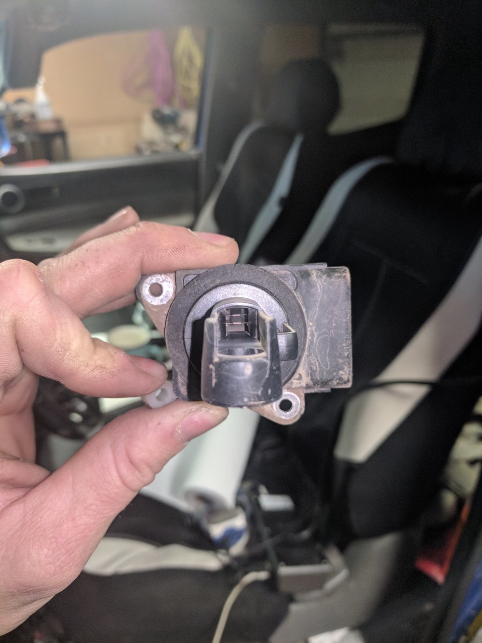

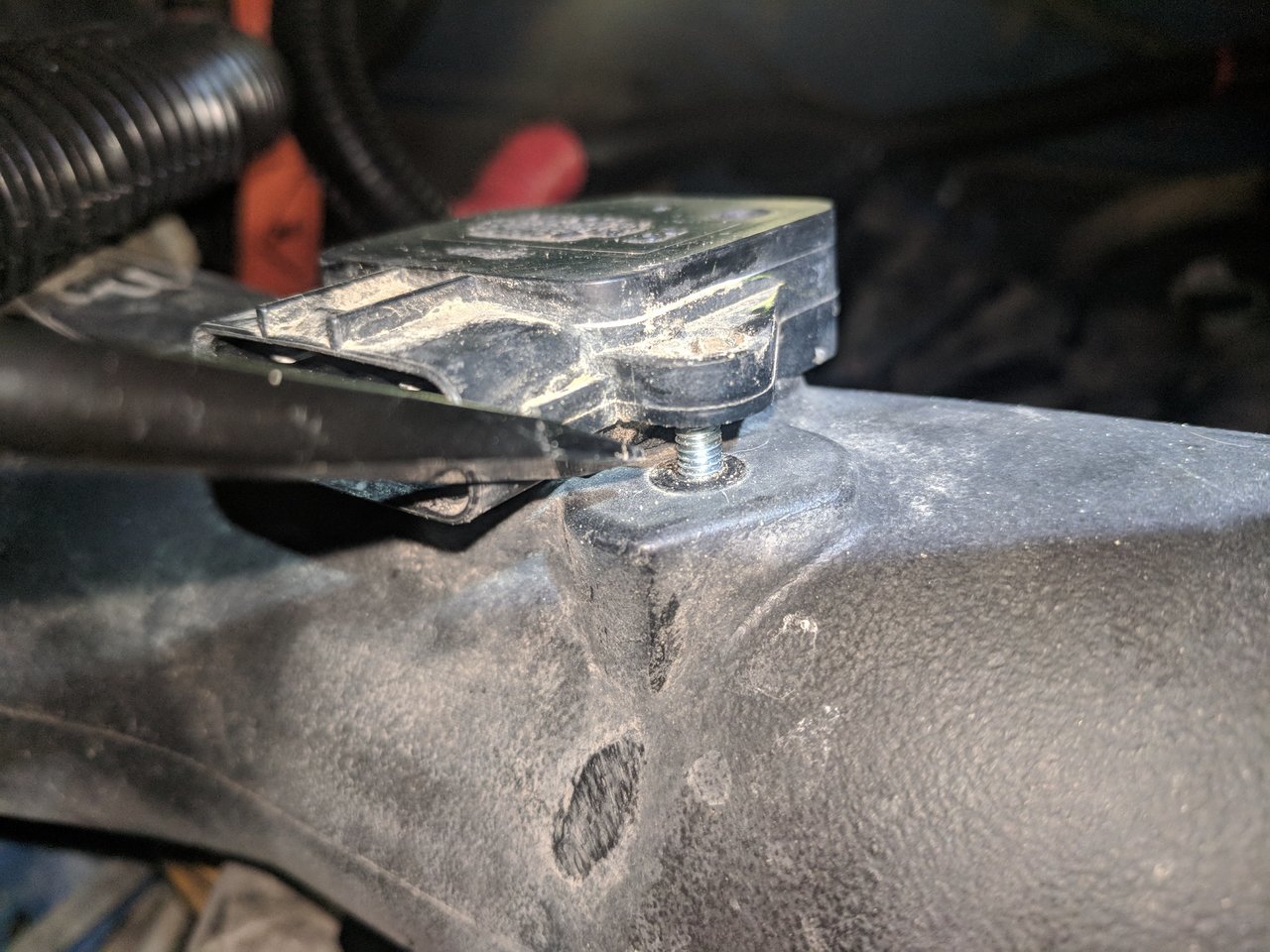

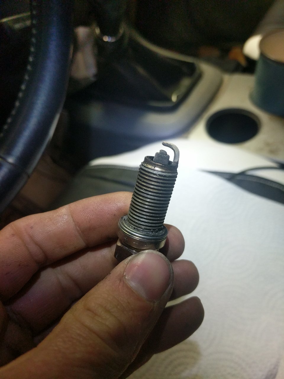

    So, I found something unique to this thread. Pulled my MAF for some much overdue cleaning and got a surprise. This white plastic cylinder popped out and landed there..IMG_20180126_190742.jpg It seems like it would fit in the cylindrical space at the bottom of the sensor, but doesn't stay put. Not seeing it on any other posts, and can't figure out how it would have stayed there over the life of this truck.. 311k kms. I intend to put everything back together sans white piece, but thought I'd put it up for the hive mind to see.

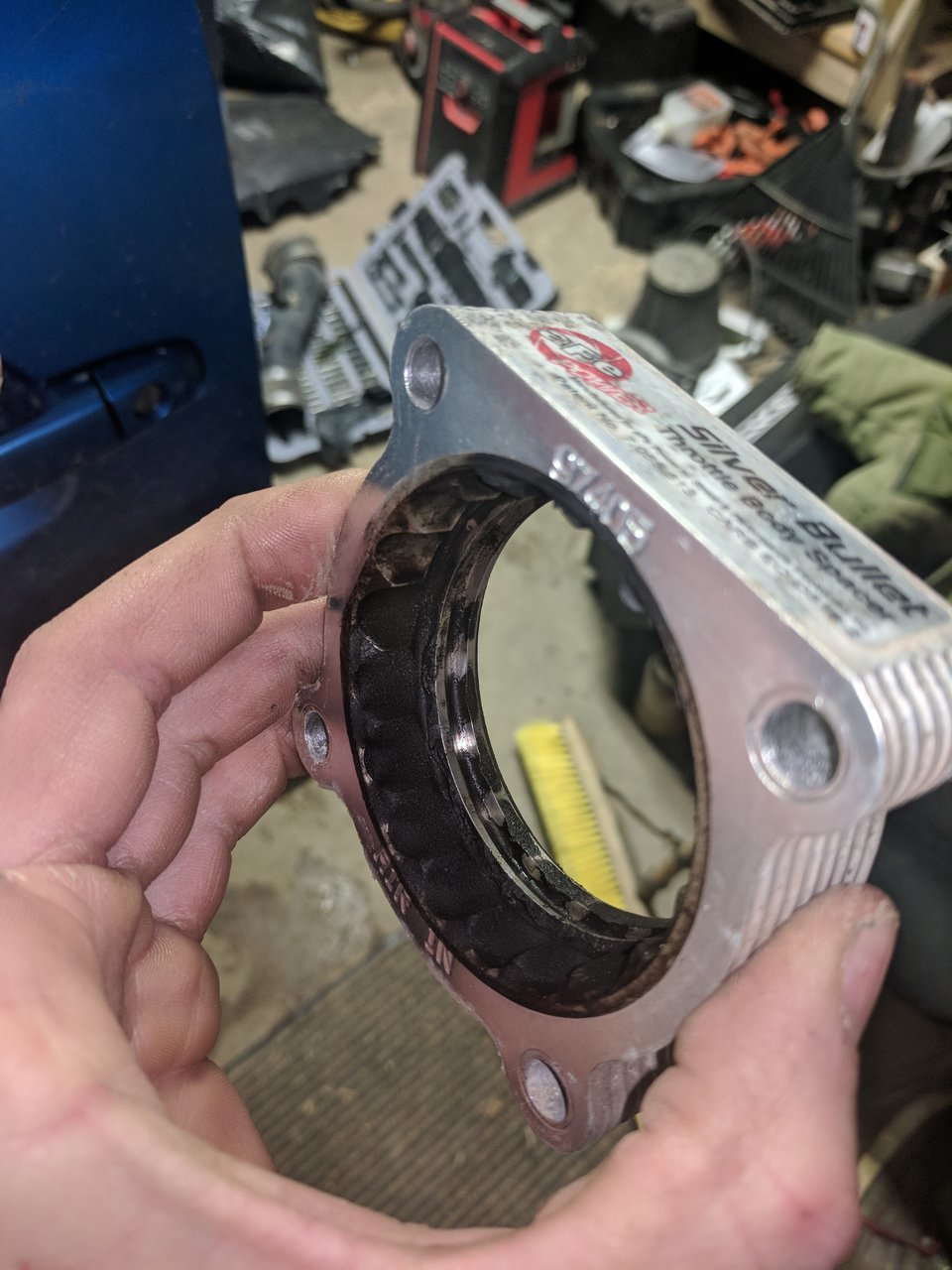

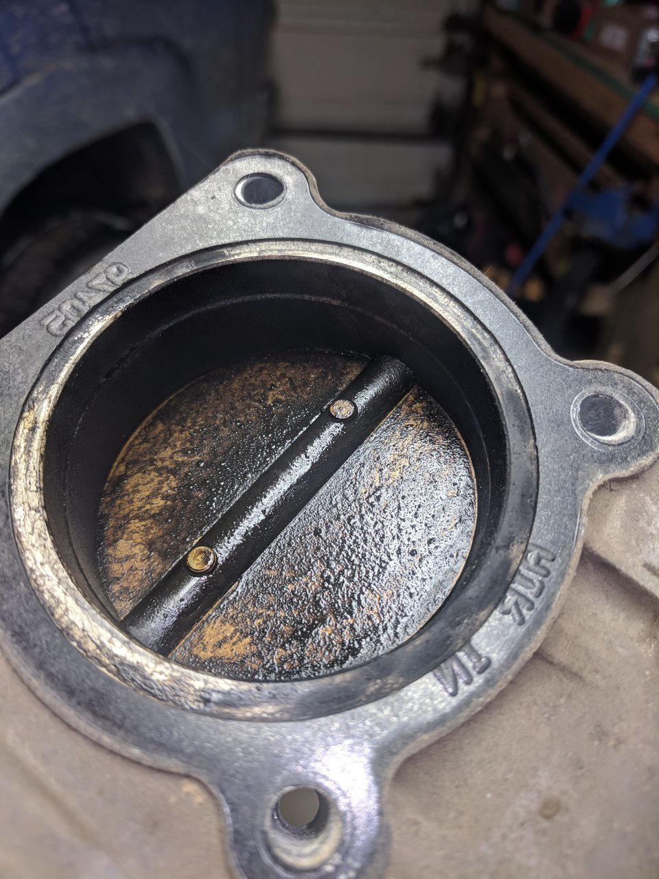

    For kicks and comparison, here's my dirty throttle body, and spacer.IMG_20180126_190345.jpgIMG_20180126_190137.jpg
    I grabbed a decent shot of the fragile little wires inside the housing that we requires us to remove the MAF to get at too. IMG_20180126_184712.jpgWill post up after a tank or two the resulting mpg increase. Got into this process by mercilessly poor mpg towing my 6x12 tool trailer:IMG_20180120_200323.jpg 6-8mpg increased to 12ish mpg with new spark plugs and some alteration in driving habits that came with more low end power.. The plugs were.. bad... Don't let yours get to this point.. 15170196193762044081333895249829.jpg More than double the spec for spark gap. I'm mostly amazed the trucks been running so well, up until i started pulling 3000lbs up and down steep grades on the daily. But hopefully with a thorough scrubbin' of the area and a quick seafoam bath I can report gains in mileage/power.

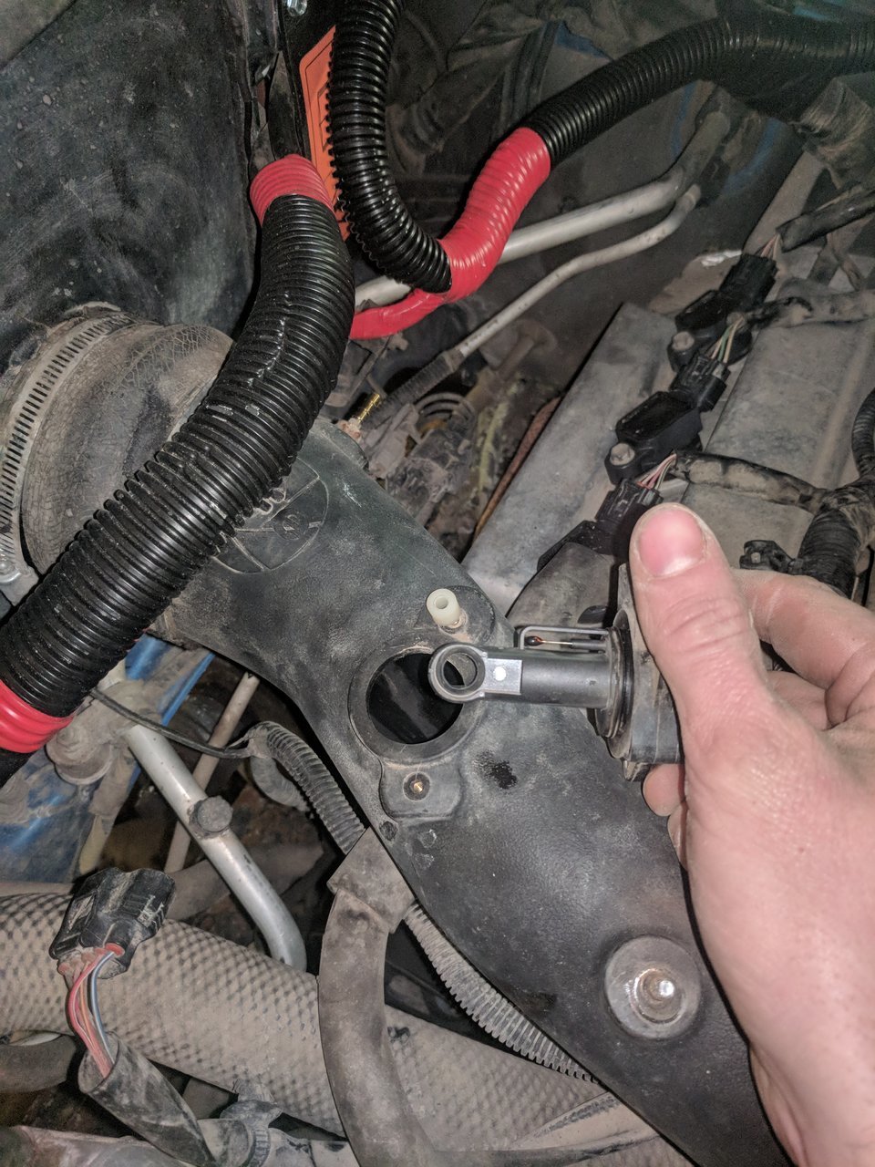

    well, figured out where the white spacer came from, now just have to figure out what happened to the second one...IMG_20180126_221500.jpg

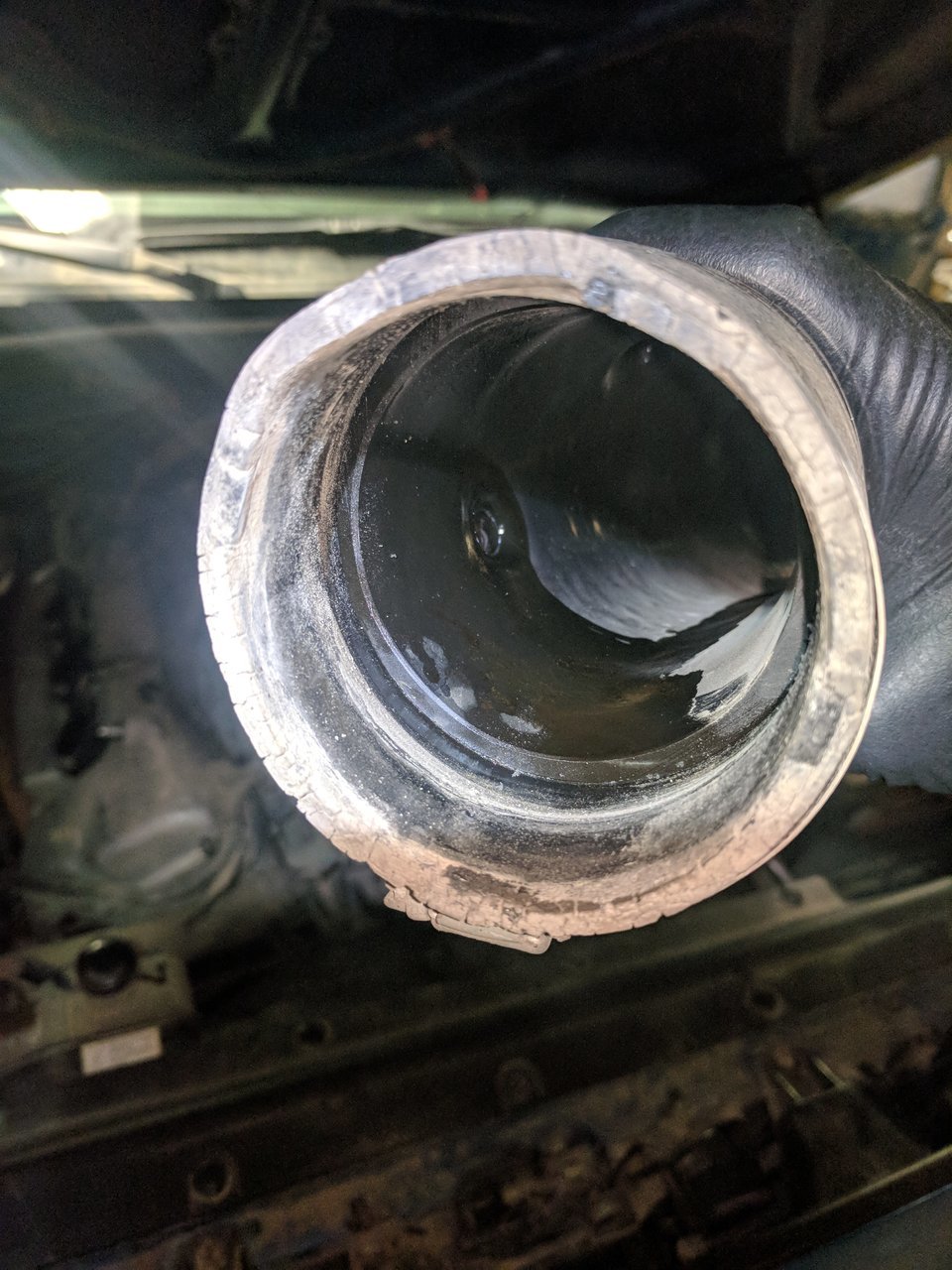

    Also, it might be worth mentioning, if your TB looks oily as mine pictured above, you should check the intake just before the TB to see whether your getting oil introduced from the crankcase breather hose.IMG_20180126_213521.jpg If this is the case you should be checking your PCV as it is likely clogged, as this should be pulling air into the crankcase, not bringing oil from the crankcase..
