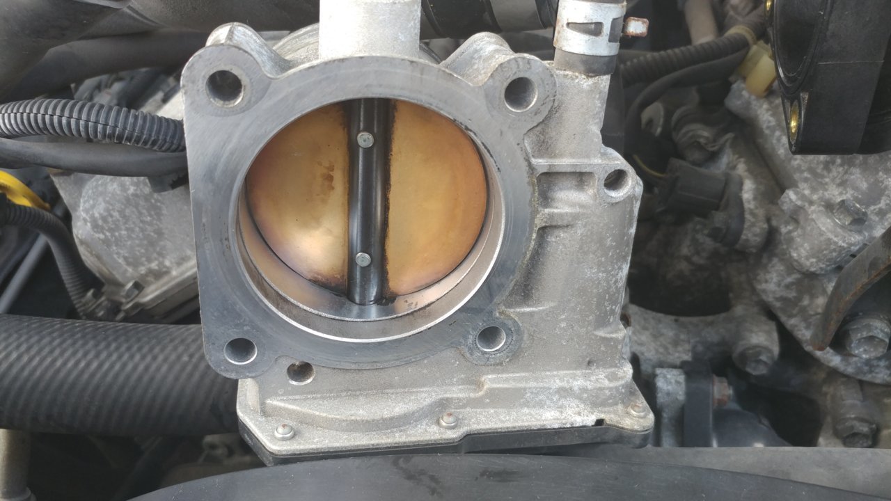

    So, here's my TB backside after disconnecting it and cleaning it as well as I could. Cleaned as deep inside the intake as I could as well too. It wasn't horribly dirty really. Took about 20 mins to get it done this time. It's definitely MUCH easier to disconnect the TB to get in there and do a better job. Also, just spray the TB cleaner on a rag and then go to it. No need to remove the neg terminal from the battery, and truck starts and runs perfectly now. A very slight increase in idle RPM but it settles after a bit to 700 RPM.
