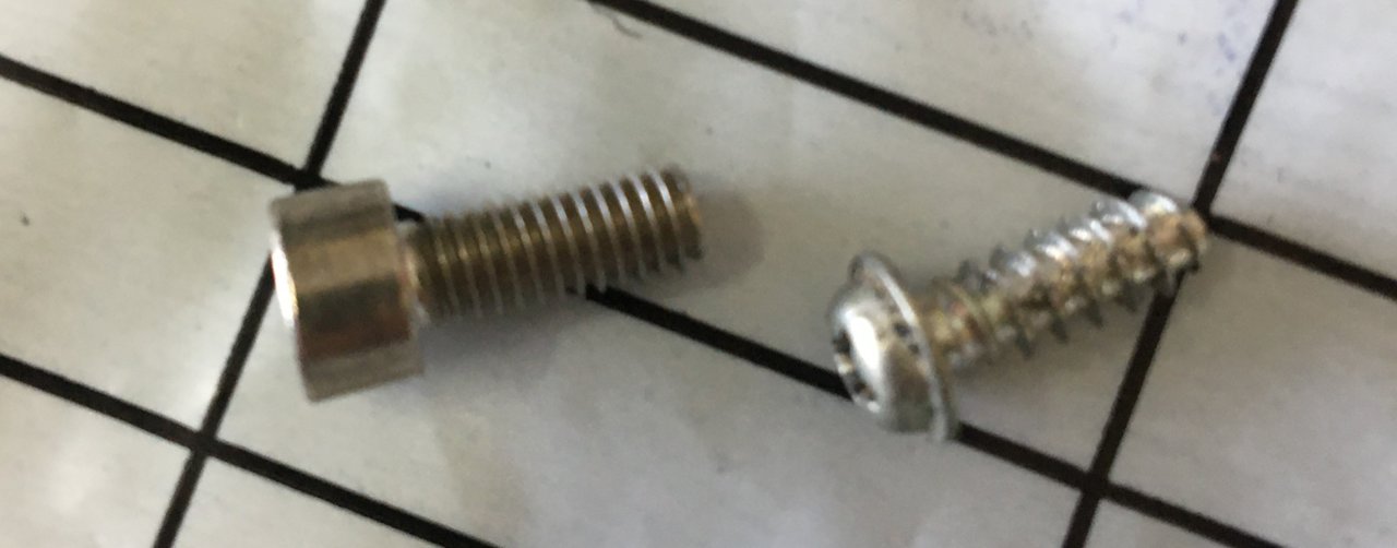

    This is a great tutorial. I cleaned the MAF sensor and Throttle Body this past weekend. Also changed the air filter while it was apart.
    I removed the MAF entirely and used the FJ video example. Even with a JIS screwdriver, the screws didn't turn easily with screwdriver skipping a few times. I had read that they could be replaced by M4x10mm screws. The threads are not compatible with my 2013. I still want to change them out in a future cleaning.
