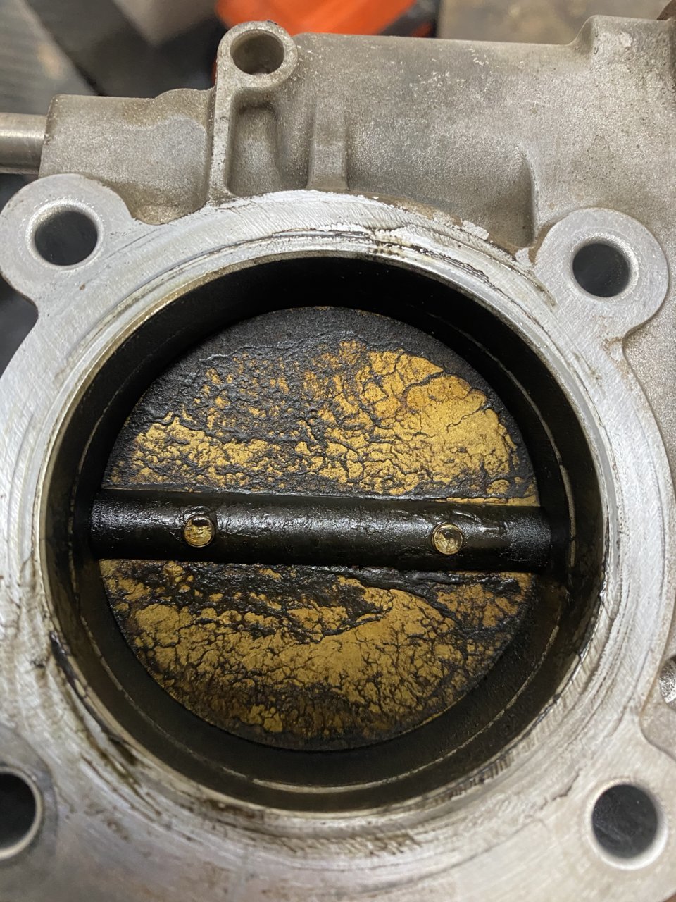

    196k miles, probably the first cleaning, since I doubt the previous owner did it. Only cost me $6.50 for the carb cleaner. I already had the electrical connector cleaner.
    The MAF sensor was spotless, but I cleaned it anyway. Easy to remove with a flathead screwdriver to help push the clip off. I've never used an oiled filter, only OEM. I bet most of us could skip this part if mine was still clean at 196k.
    The MAF side of the TB was not so bad, but the side leading to the intake was gross! The sidewalls were gunked up pretty seriously. The whole thing took maybe an hour since the cleaning took so long.
    Idle and throttle response is so much better!
    Both of these pics are before any cleaning:

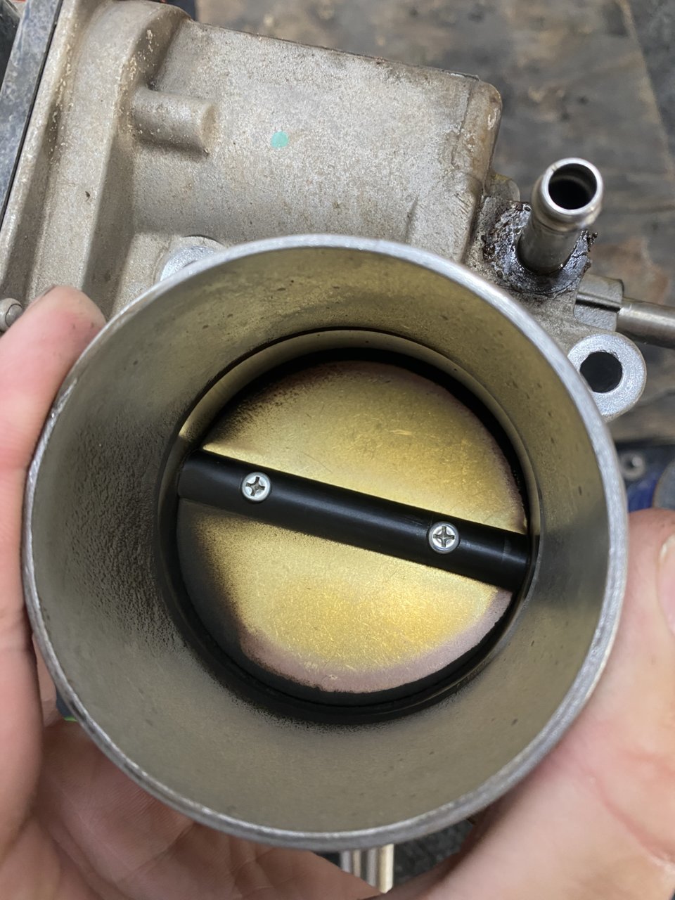

    The black piece the throttle body connects to had a lot of residue/gunk. How dod u guys clean back there? Thinking maybe from extra oil in a K&N reusable filter. Hopefully not something more serious.
