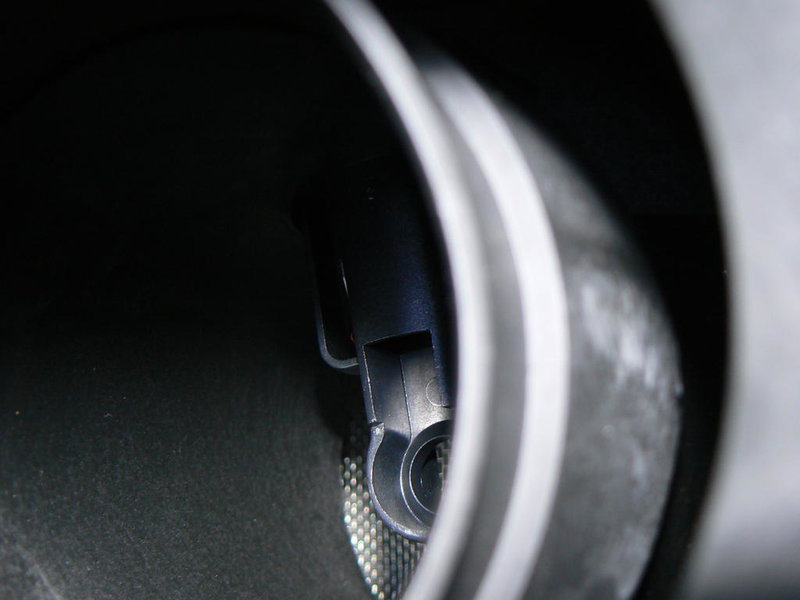

    What color is the MAF sensor supposed to be? Mine is silver on top and copper colored at the bottom (loop). I have my secondary air filter in place. How should I clean this without getting the secondary filter sprayed?
    This the best pic I could get.

    Just take it out and spray liberally with the mass airflow cleaner. I had a real bitch of a time getting the secondary filter out. I damn near broke it. And as stated for the love of god, don't break the wires inside or you'll be out a few hundred for a new one.
    Also, when spraying inside the throttle body make sure the red hose on the can is on tight. Your ass will pucker faster than a clam at high tide when it goes shooting out and into the engine and you have to extract it with pliers.

    Thanks for the help. Do you mean take the MAF sensor out, or take the filter out?

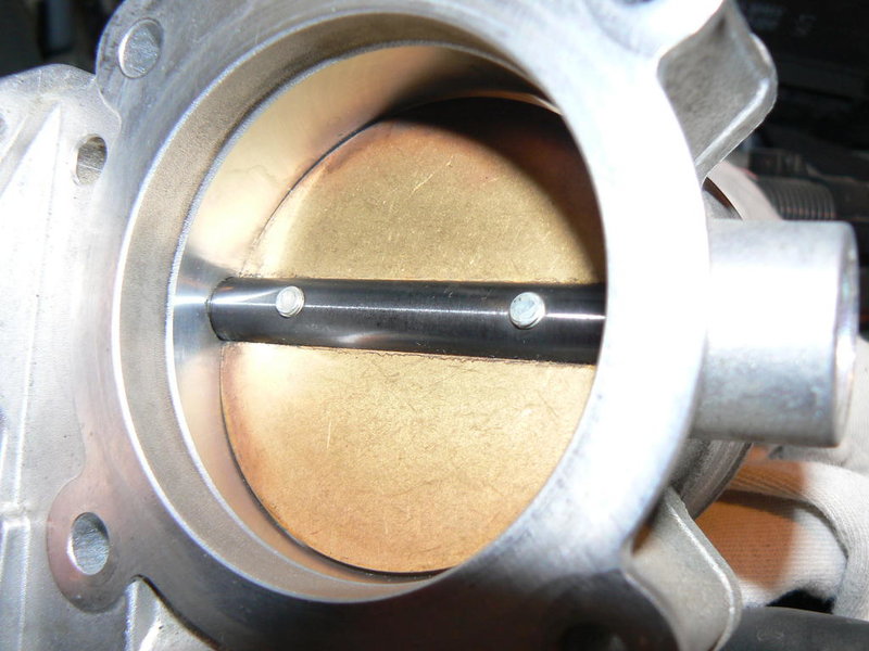

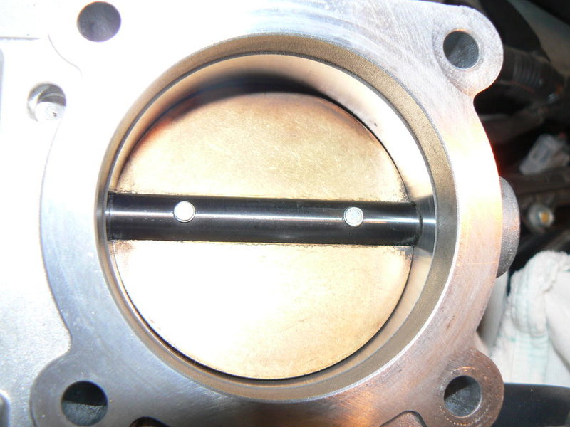

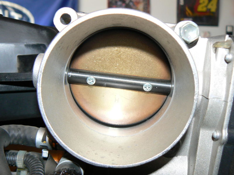

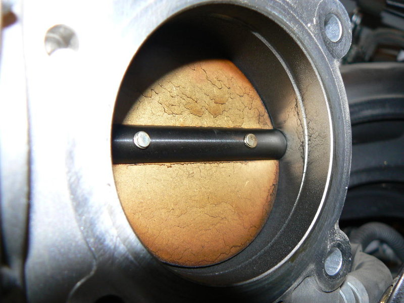

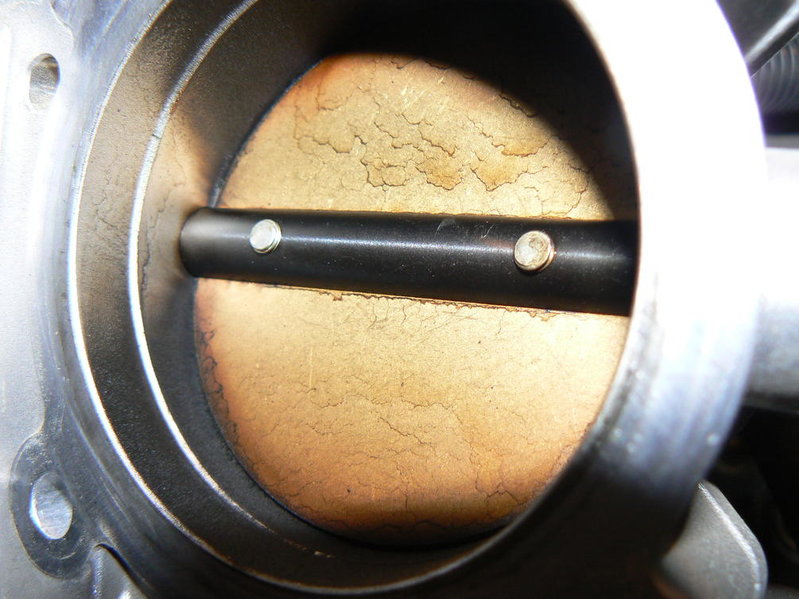

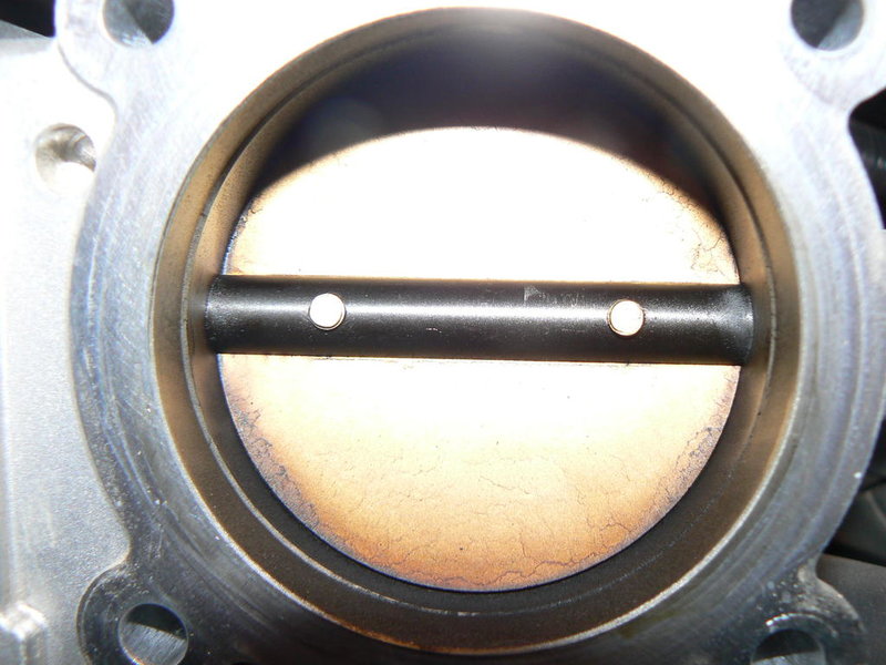

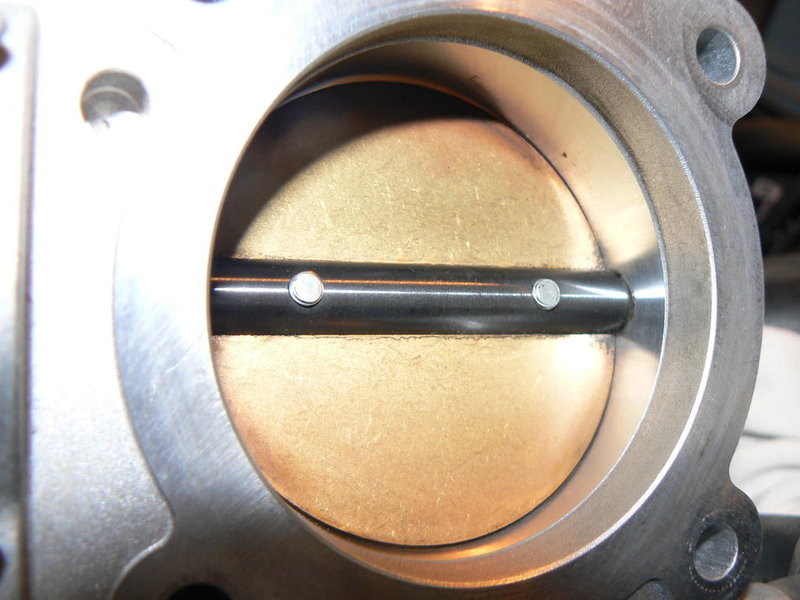

    MAF Sensor did not look dirty from what I could see. I could not figure how to clean it with the secondary air filter in place without soaking it as well. I skipped the MAF Sensor cleaning.
    Did the throttle body, and boy what a difference! Took it off to clean the back end as well. That was the dirty side. I am learning more about mechanics thanks to this website. Great write up, and very detailed pics!
    Here are some before and after pics.

    I took the MAF sensor out...Blew the top off with an air duster, unscrewed, cleaned sensor, wiped edges, and re-installed.

    Did it come out easy after you removed the 2 screws? Was it difficult to get it back in without destroying the wires?

    It might stick a little, unplug the harness before you take the screws out, it should come out pretty easy, don't forget to reset the ECU before you fire it up

    I took both out.
    Disconnect the battery. Turn the key to ignition to clear all power from the system. ECU reset.
    Oh yeah, the wires are well inside the little conical housing. You won't break them unless you drop it or cram something inside. :) You don't have to be super gentle with it. Just don't use it as a hacky sack.
