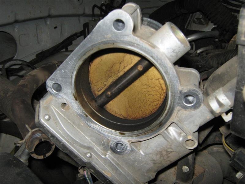

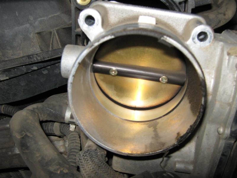

    Thanks for the great write-up Sean! I attached a couple of pics because many of you doing this aren't running stock filters. I've got the stock SR5 intake and still had my secondary charcoal filter still installed (notice past tense here because it looked dirtier than any air filter I've ever replaced and can't imagine the airflow restriction when it's that bad). Over 7 years and 118K miles later, the TB and MAF were quite dirty.
    One other thing I would recommend based on some of the comments is to remove the MAF to clean it. The backside looked completely clean, whereas the front side subject to the air flow hitting it was caked with the same oily dirt as the TB!
    Front and Rear (in that order) TB pics attached.
