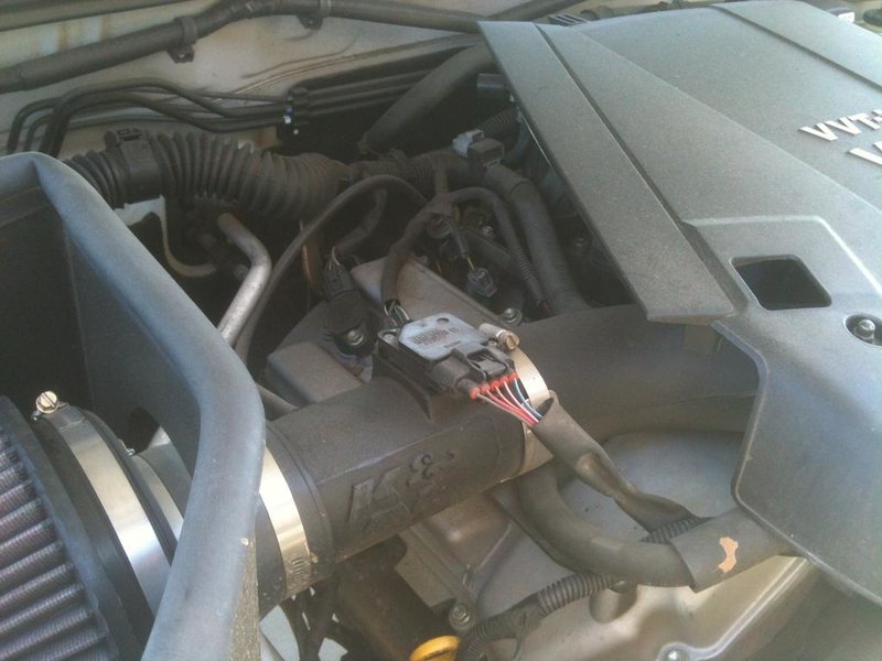

    i got a k&n cai and i was wondering if it has a maf sensor lol prbbly a dumb question but just wondering and where would it be?

    If it has a wire harness plugged in to the air box about 6 inches from the throttle body then yes. I'm guessing all later models have them...

    im thinking i got a MAF sensor lol, so how would i clean this? do i just spray it on the wire harness or where?

    That would most definitely be a MAF sensor.
    Read the first post of this thread and it explains how to clean the MAF.

    he has the stock maf sensor and housing tho, do i just diconnect the air filter tube leading to the TB and spray down that way and call it good?

    Yes you can definitely do that, just make sure to disconnect the negative terminal of your battery anytime you work on your truck and disconnect your MAF. If you choose to pull the MAF out of the intake tube, make sure to NOT touch the wire at all! It is VERY sensitive and will brake if handled roughly! Either way works but just be sure to be careful and take your time. Also make sure you use a MAF cleaner and nothing else.

    ok cool thanks, ill just disconnect the maf and spray down the tuber at it, i dont wanna take it out cuz id prbbly break it lol

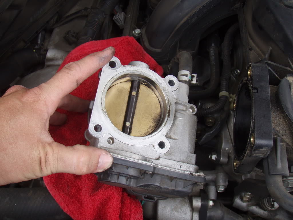

    You stated that the TB gasket is actually an O-ring. Does that appear to be a delicate item. I've never pulled this apart and don't want it to tear and leave me needing one.

    The o-ring was stout. Even when I cleaned mine again at 150,000 miles the o-ring was in good shape. The o-ring stays seated, I never had to do anything with it.
    The black piece the throttle body butterfly attaches too has the o-ring seated in a groove.

    I did pull the TB off to clean behind it... that was a snap.
    As for the MAF sensor, I ended up removing it from the housing and spraying it separately. My housing still has the Charcoal filter that sits behind the air filter. It doesn't just pop out and I didn't want all the spray saturating it. Reading about how delicate they are, I was nervous, but no big deal. Two screws and the connector, and it pulled out easy.
