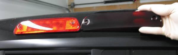

    This is 1 coat of VHT, I think it is definitely dark enough for my 3rd brake light.
    The only issue is I also had a bit of wrinkling, there was wind when I applied the first and only coat. I may take it down and sand it clear again and do one more try. I used krylon clear gloss, works great.
    FTR, I bought VHT on ebay for 15 bucks, arrived in 2 days.
