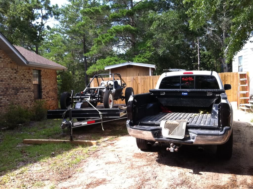

    Stripped off old tint. Now starting over haha
