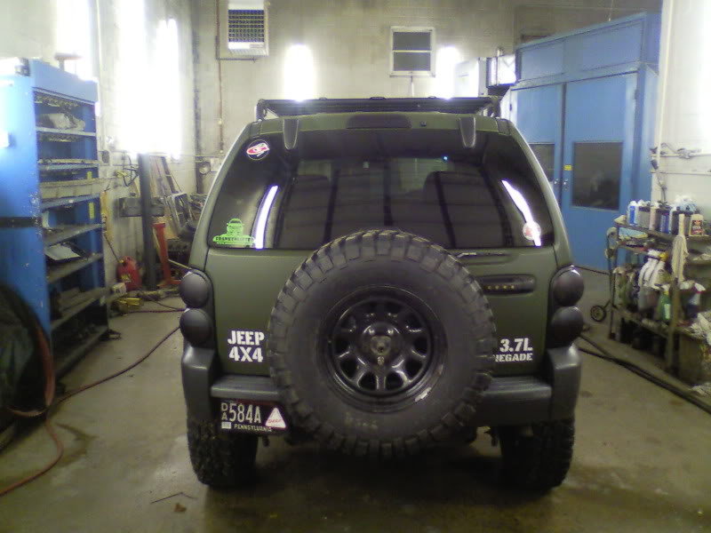

    great write up.... just about the same as i did mine. sanded with 2000... taped off what i wanted to keep clear (brake/running light and back up light). then nite shaded... untaped.. then i used good PPG glossy clear coat sprayed out of a paint gun. I like the good quality clear better then the aerosol clear just because it will last longer... and i didnt need to wetsand and buff/rub to get it smooth (it lays down really nice).
    so you can do all the nite shading yourself but it's always a good option to pay a bodyshop just to shoot some clear on the lights.
    i did my mirror side markers, 3rd brake light, and tails at the same time. I used 3 light coats on the tails and mirrors, 3 heavy coats on the 3rd brake light
    used the same system to do my old jeep tails/3rd brake light... only used PPG flex&flat clear (flat clear coat) same as i used over the green base coat on the jeep its self
    can use aerosol flat clear to get the same effect.

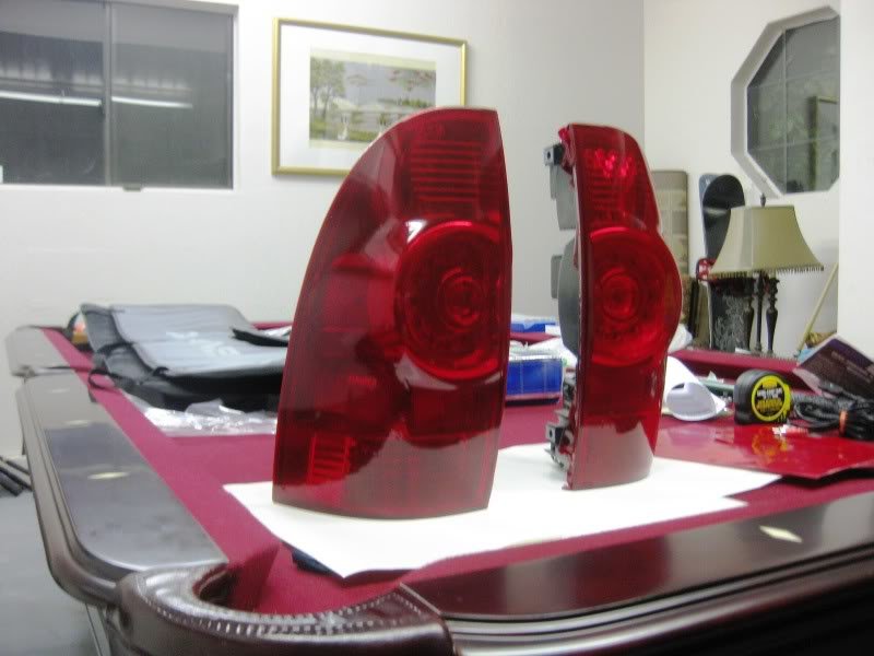

    Picked up a set of 09 tails and tinted them red. I decided to use tint instead of painting them so removal would be a breeze if I ever decided to change the look.

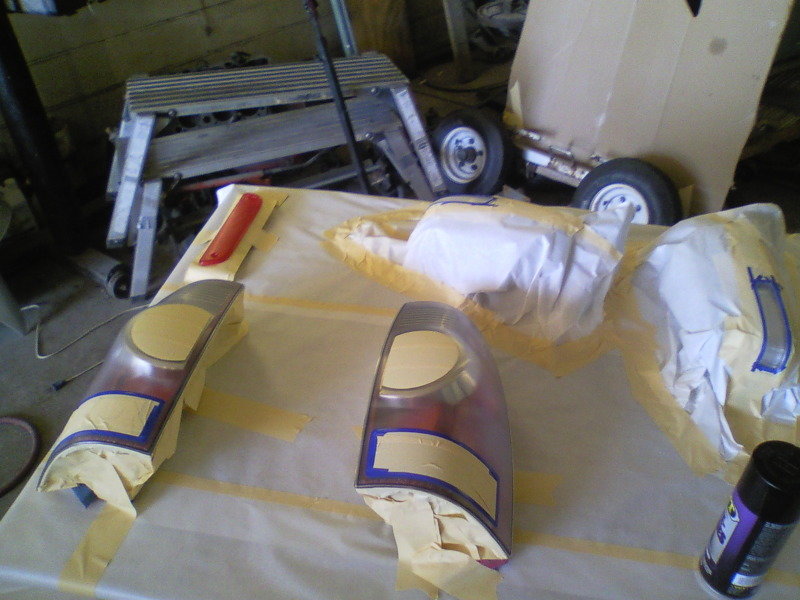

    For taping off the brake light i got an old school drafting compass (the tool you used in highschool to measure angles and draw circles) and put the point of it in the middle of the brake light (theres a little dimple). Then put the end with the pencil to where i wanted to tape off.. tightened down the compass so it didnt move. Then got some 2in masking tape and put it on a plastic cutting board.. used the compass to draw my circle. cut out the circle. put it on the tail light where you want then marked the straight line with a roller and used a razor blade to cut the straight side of it lightly (just enough to cut the tape).
    to tape off the back up light i used 2 inch tape to tape off most of it close as i could to the edge then used some flexible 1/4 inch fine line tape to do the edges.
    you can see them taped up in one of my photo's above.

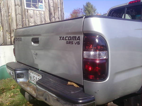

    Took me 3 hours too. I did this process but, two coats of night shades, like 6 coats of clear after that. I haven't buffed or anything else yet because I don't have that stuff. [​IMG]

    I agree with the note on your back window... Good job! Looks like you taped off the back-up light too.
