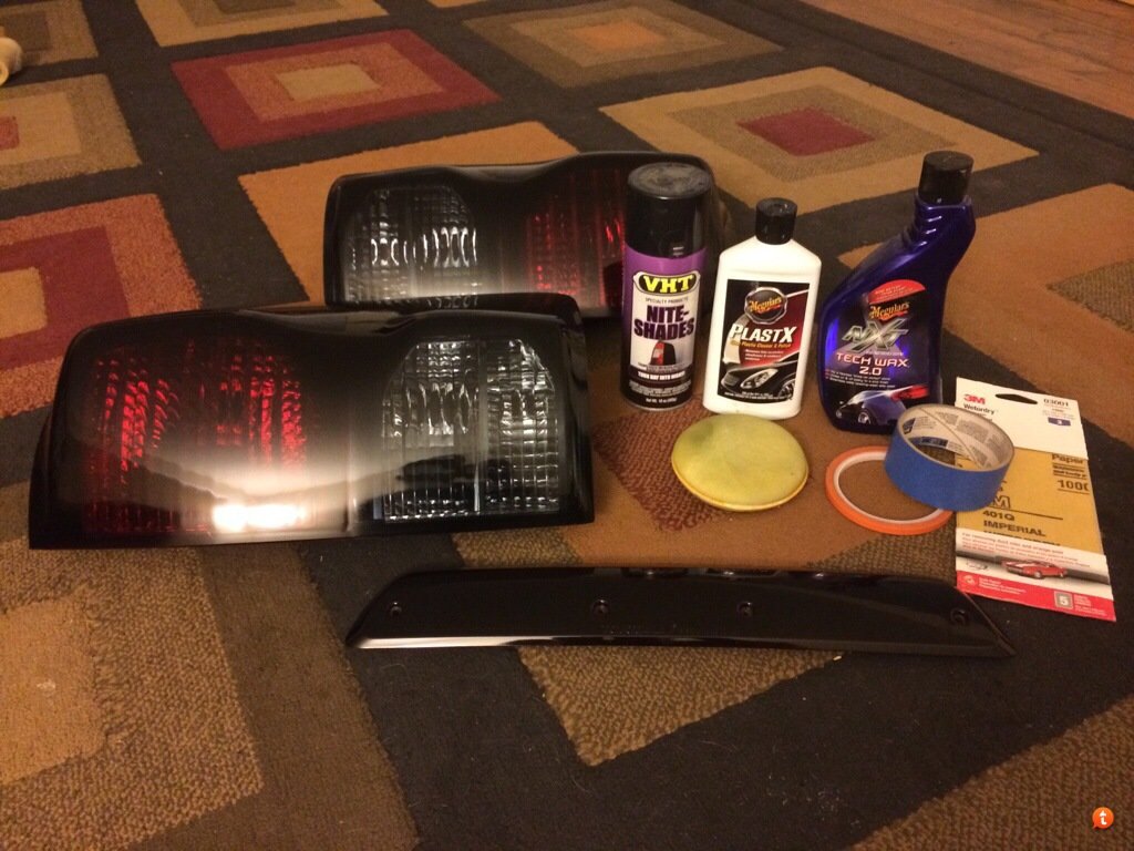

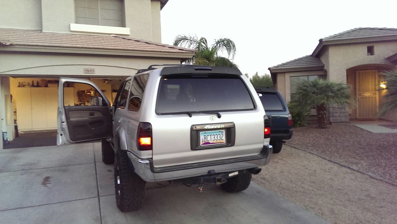

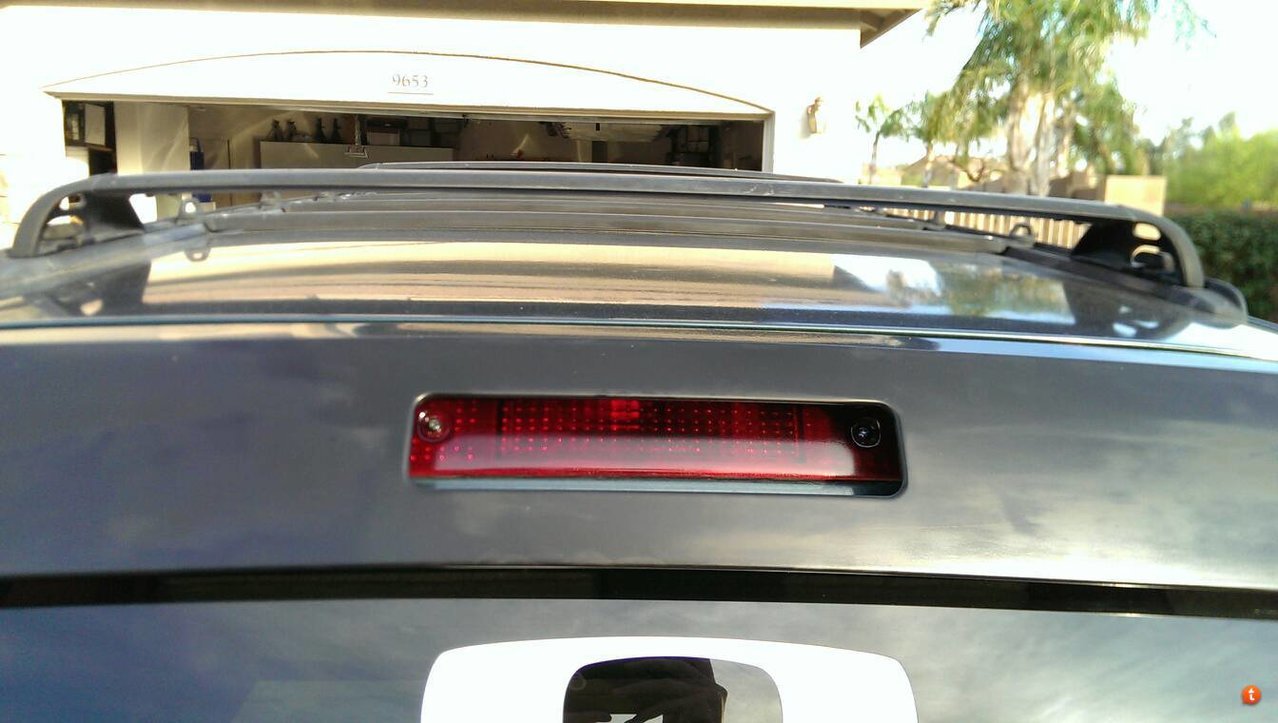

    Just did my 3rd brake as a test run! Highest grit I used was 600 because that's all I could find and I wanted to get it done. For the tails I'll use 2000 like the op says. I like how it came out. This is two coats.
    tasa2ama_dbbdbf38b61c8031a4d8aaeac9fa72e3e8a5e8a4.jpgehuqeqy2_edb5e9c6573ecb4213beaf221ecbbcfdf7de9a3d.jpg

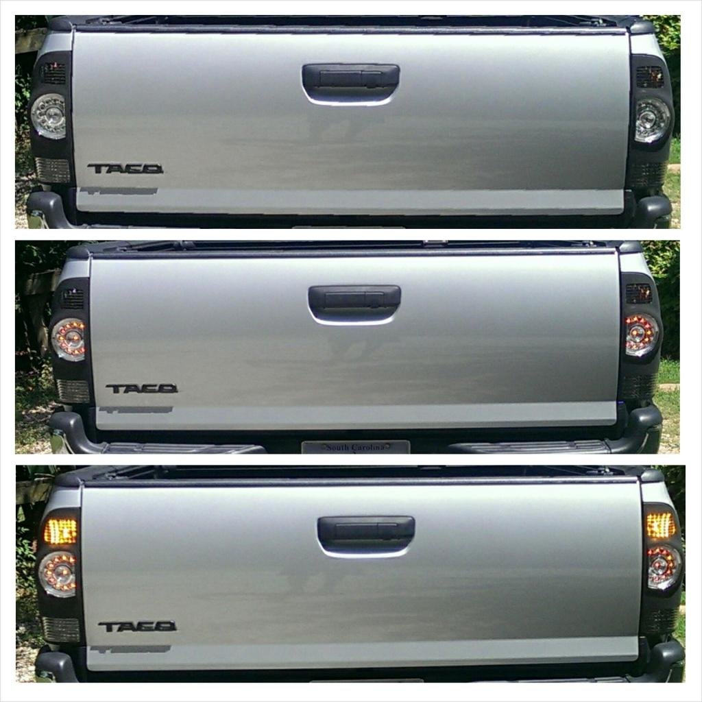

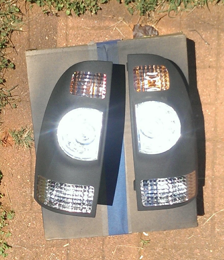

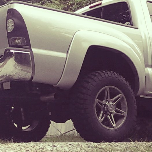

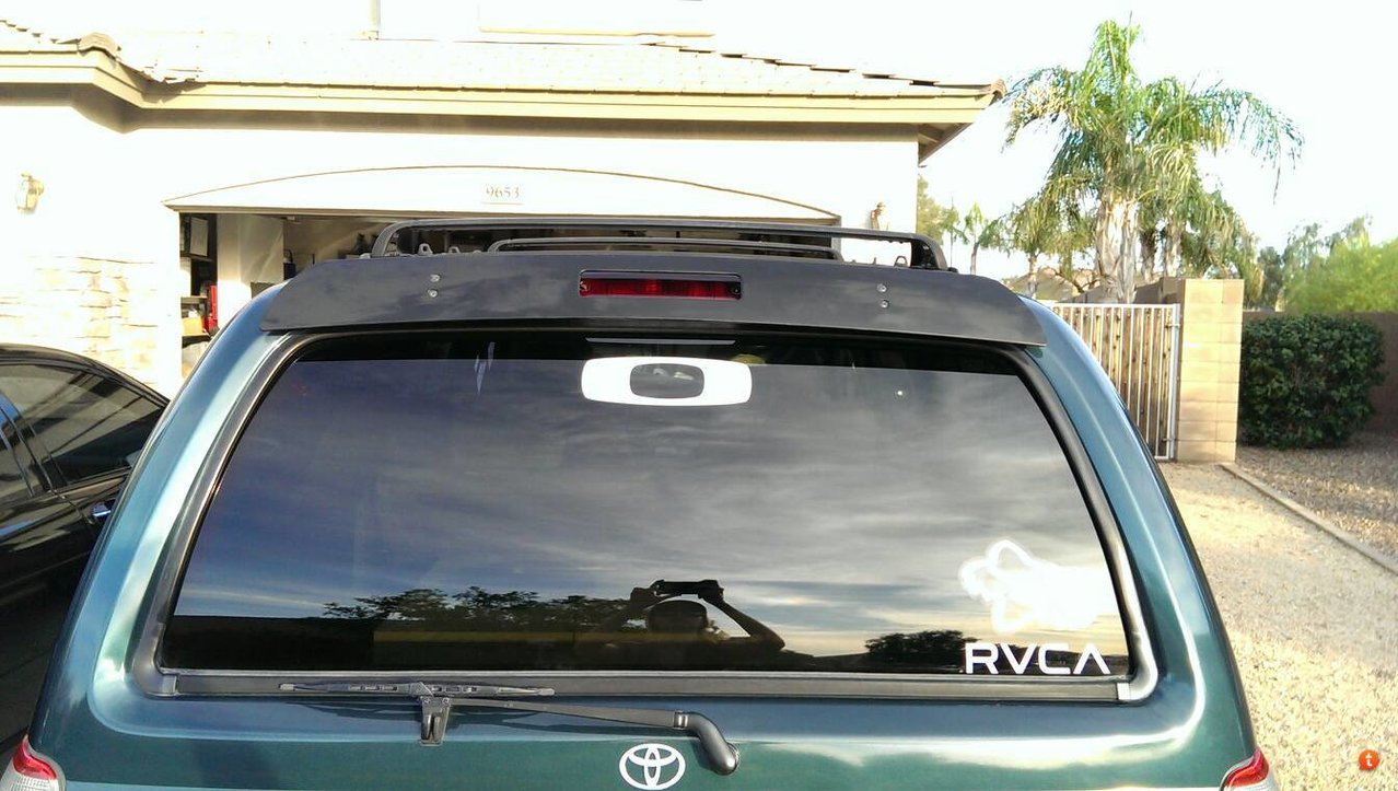

    Did a test run on mine with plastidip to see if I like the layout I want..
    IMAG1029_1_zpsmhlaqezn_73c6ef9beb432d7684ea6c7c7c3093818f354dfc.jpgIMG_20140802_094236_zpsqq4xcvhp_2444191868320b4f6c93d29be19c881e8f82cd67.jpgPhotoGrid_1406660323415_zpsikbyfgsw_a316f1abe2d02dbcb2c9cb461c8df81c1f44eccc.jpg

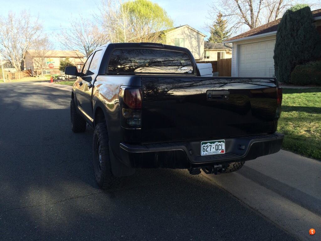

    Did my new truck. Three coats of tint and 6 I think of clear. Came out great! I hand waxed too.

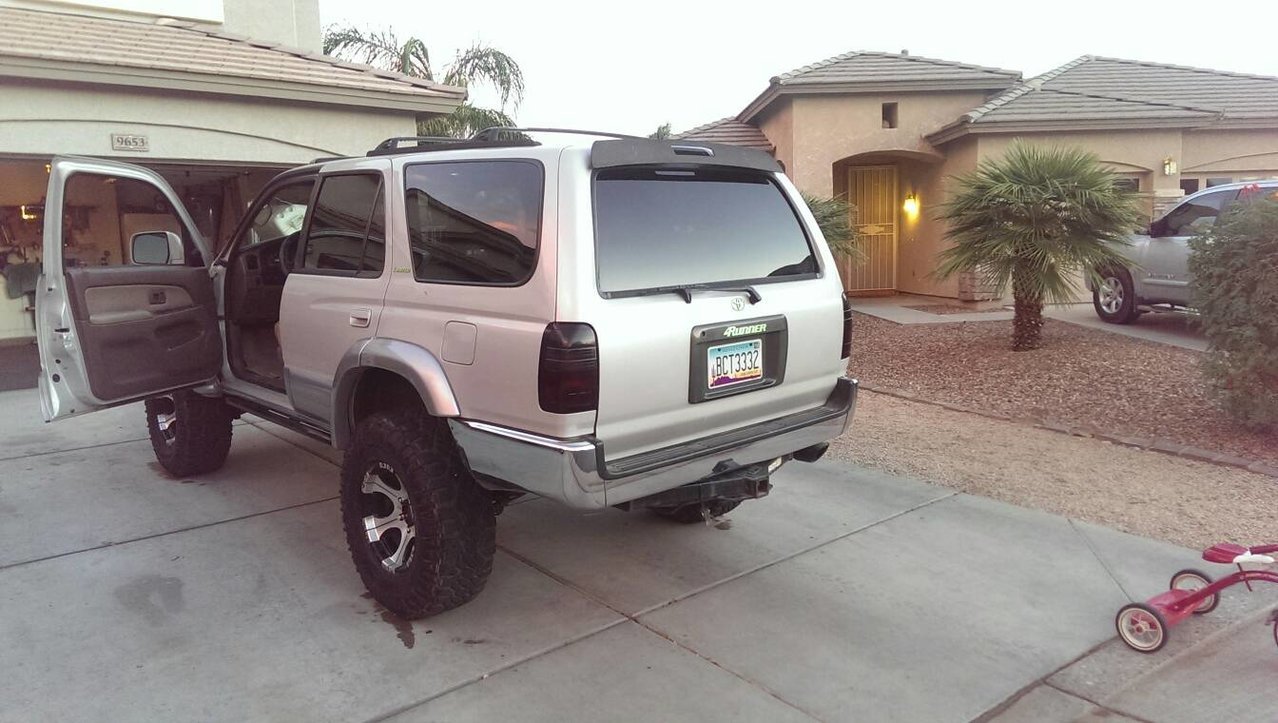

    Came out very nice! I just got done doing mine , I used the clear krylon fusion and it didn't come out as glossy. But I did it all at night (and 50 degree weather BTW - came out fine) I'll post pics tomorrow.
    This writeup was very helpful, should be a sticky in the diy section:cool:

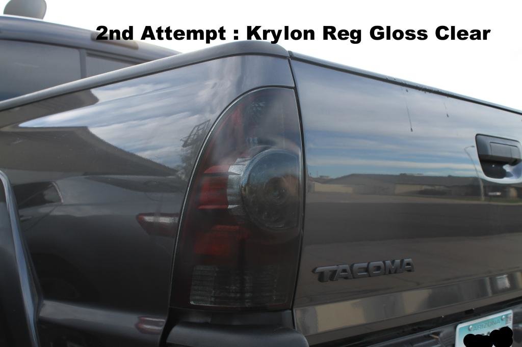

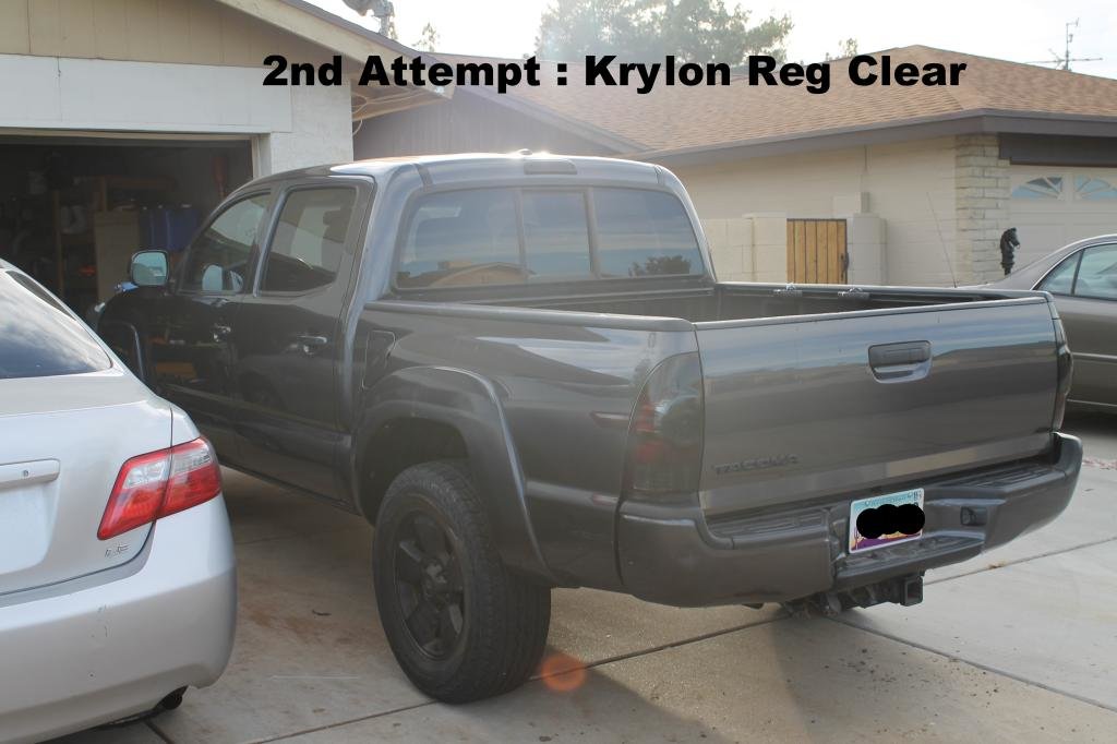

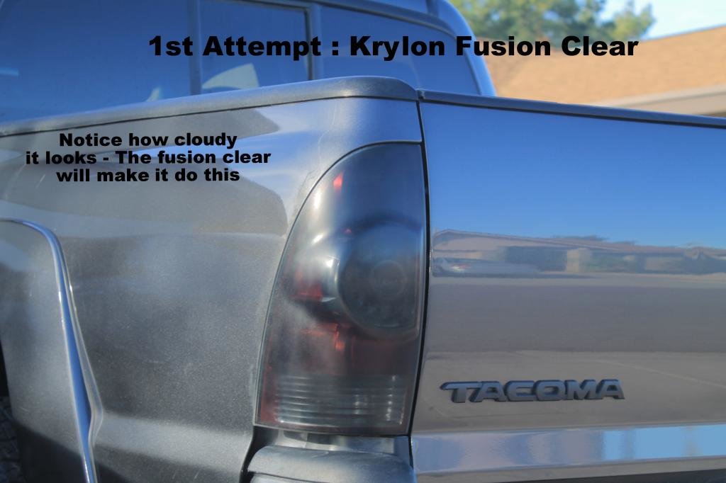

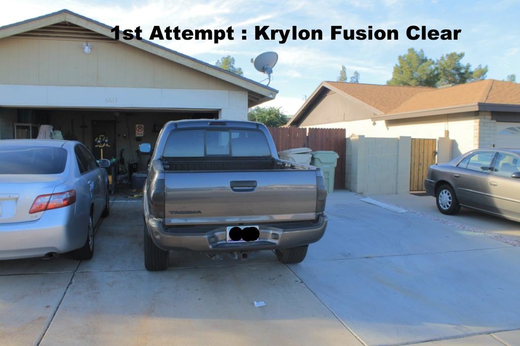

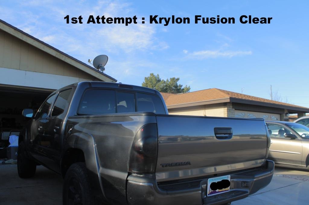

    Okay so just for future people who use this how to... do NOT use krylon fusion clear as it will not leave a glossy finish. It Leaves a matte finish. Even with wet sanding all the way up to 2000. And using the 3 step buffing/polishing with a drill... so I stripped off the tint and my clear in 5 mins with this video http://m.youtube.com/watch?v=Nd76ekCXjKA
    Also 3 coats of vht is more of a "black out" look and cured quite dark which could give you some problems with law enforcement. I re sprayed mine with 2 coats and it is more "smoked out" look and used the krylon regular clear and it came out much better with a glossy look

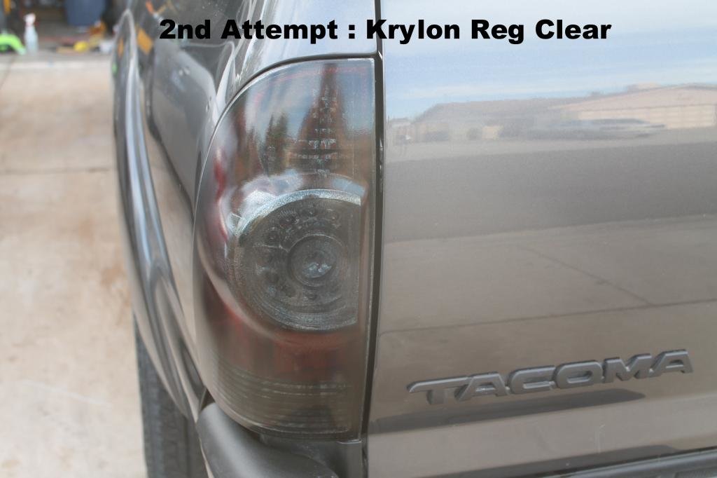

    So Here are some pics of the aftermath. I used the same sanding and buffing process in both. And both feel as smooth as baby's bottom, though the fusion clear came out very cloudy and matte like finish. I Used the Krylon Regular Gloss the 2nd time and came out MUCH better.
    807a93d8-888e-4b15-ad19-6da49dd4c155_zps_ad8f8c136d28d9c3e4e02c869562eeab644e66b0.jpg
    96f3d735-7ea4-4b1e-9d43-2fa2077b67bc_zps_1f02873b79e03ee7828ff07f4bd4abfc8b79ad67.jpg
    1baa5fce-5dbe-4cd5-a382-5735ba2f98fc_zps_65a66927e073c138f3f7b553e02f3becbaed0e6b.jpg
    2nd Attempt
    9d4d93bd-a698-4a43-bd44-f2c762a0a4e1_zps_6c246943186f588b61d8f7114faffc267d35557c.jpg
    4e7d0d0b-1642-4532-bd65-0676d763e70c_zps_0345df8bc6c751130f38e4c8fa4118af80db3019.jpg
    0e397d6c-7617-4327-8d01-07f3b89de21b_zps_fc53e92bece50f1ea6c5b7576f7dbcd0ac336a75.jpg
