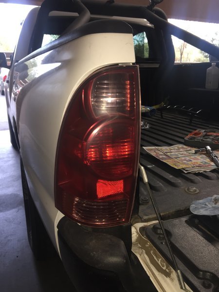

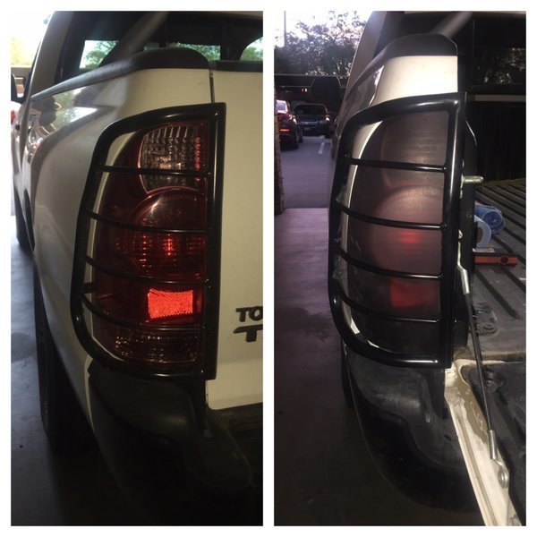

    Did mine today. Turned out great. Thanks for the good write up!
    Before
    After

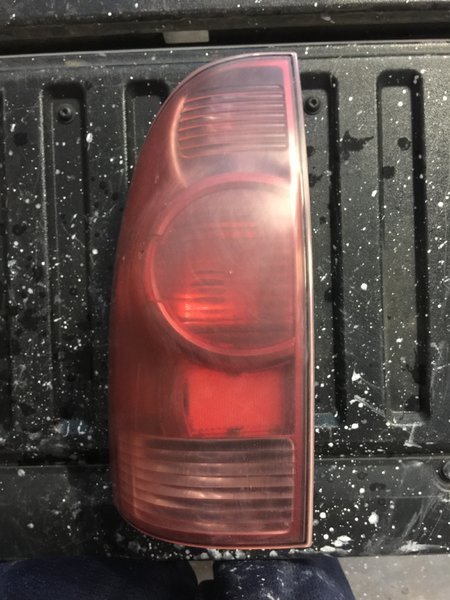

  20. Nov 22, 2016 at 12:26 PM
    #520
    SamGoingHam
    SamGoingHam IG: SamGoingHam
    Oct 8, 2016
    #199212
    1,489
    Sam
    Phoenix, Arizona
    2014 TACO 5LUG LOCKED

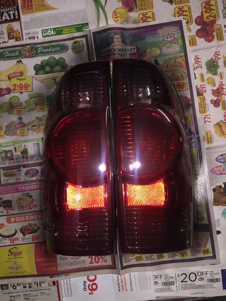

    Before
    800
    1500
    2000
    3000 (Left2000-Right3000)
    6 layers of tint
    Fuck ton layers of clear
    Before&After
    Cured darker than expected, but I like it. Still need to buff it whenever I get my hands of a wheel.
