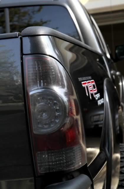

    EDIT:
    I tinted this member's tails last week by adding his factory OEM magnetic gray paint to 10 parts clear coat. This was after 8 coats. I've heard its really easy to over tint ur tails with the spray can stuff:

    You are not thinking thoroughly. The vinyl, looks like ASS. It is grey, not black. It is a pain to apply. Vinyl WILL start to wrinkle around the round edges of the tail light. If you spray your tail lights, don't just get rid of them, sell them and make more money, and get stock ones. Yes, paint fades over time... if you do not wax it. I wish I could have my tail light right next to yours to show you the difference. We know what the vinyl looks like, but thanks for sharing.

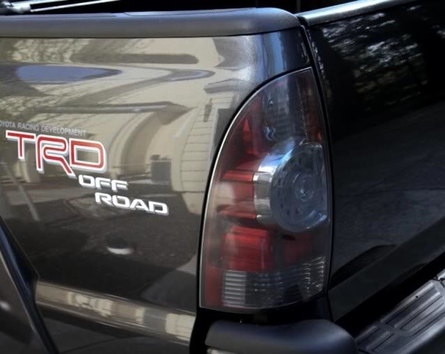

    From the Pics it looks like i rather do the Night shade, although a paint gun and car paint sounds more professional, i personally dont like the dull look.

    Yeah...^^^ I'm right there with ya. Niteshade is a deeper "Tint" if you ask me. I just bout the stuff today. Planning to do this weekend!

    Looks awesome and not too dark like some are! I want mine to look just like yours, gonna have to try this out. :thumbsup:
