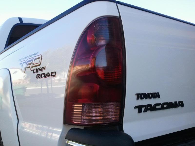

    Just did mine. I didnt want mine dark at all.

    ^^Nice job dbolt, about as dark as mine:thumbsup:
