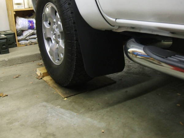

    i know, trimming your mud flaps is a simple process, but i dont think i have ever seen it documented with pictures. so here is the way i did it:
    Here is the stock mudflap (right side). it hangs down about 12 inches below the truck.
    I cut out a template of the mud flap from a piece cardboard and then trimmed the template 5 inches shorter.

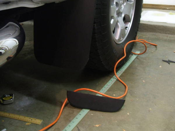

    here is the 5 inches that was cut off.
    here is the completed cut on the left side.
    amount removed from the left mud flap.

    Nice wrightup. I was wondering when someone would do a wrightup on the flaps. I am suprised no one has ever marketed shorter mudflaps for the toyotas. I bet they would sell.

    Used the tin snip version and only removed 2.5" of material. Worked great with a little finish sanding around the edge in about 10 minutes.
    Before:
    After:
    Drivers side after sanding:
    The rear flaps stock hang 10" below the truck. The front with the 2.5" removed now hang 9" below the truck. Notice the custom high dollar $$$$ wheel stops!!!!
