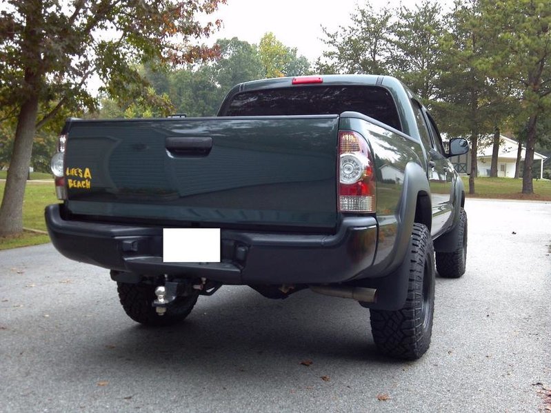

    I cut 5" from the front and 4" from the rear (just above 4X4) flaps.
    Still 1" below below centerline of rear wheel (I have 1.5" of suspension lift on rear) to still make mine state law compliant.
    Less mass, less buildup of snow and mud, less likely to break.

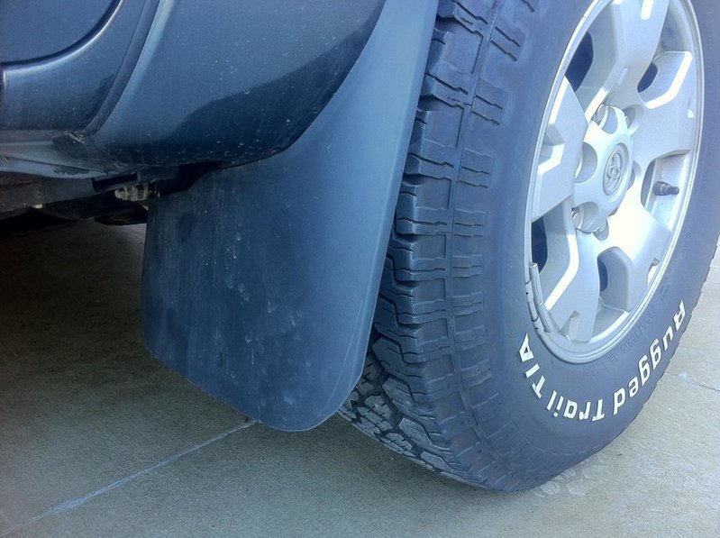

    OK, so this thread popping back to the front inspired me.
    I grabbed a pair of tin snips and popped the mudflaps off and gave 'em a trimming.
    I used one as a "template" and used a pencil to rough out the cut.
    It literally took me more time to get them off without breaking the fiddly panel attachment thingys than it did to trim them.
    Got out and back in before the end of the fourth quater! :)
