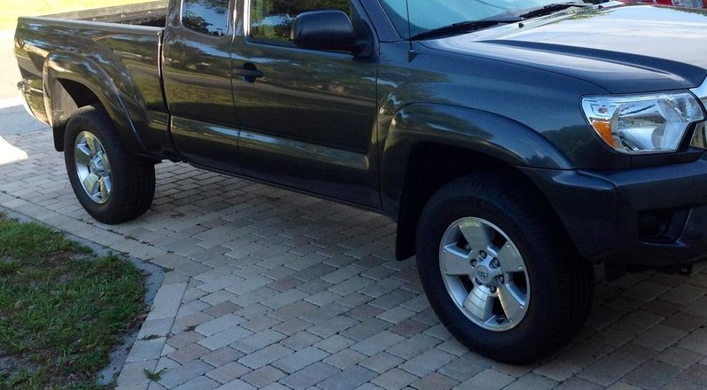

    Never posted up a pic of my trimmage. Here's how they turned out..............

    How much did you trim off front and back? Looks great!

    Thanks, trimmed about 2.5" off the rears and 4.5" off the fronts. I trimmed both sets to be 13" off the ground with truck unloaded. I measured and marked them how long I wanted them to be from the ground while on the truck before removing them & cutting.

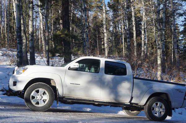

    Cut down my front mud flaps yesterday. Cut them down to about the same length as the rear ones. Used Fiskars shop boos scissors and it worked great.

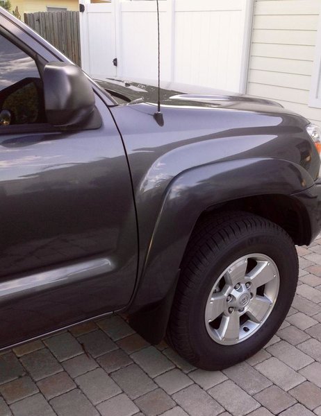

    I finally did this today after having my truck for two years, it looks much better. Tin snips worked great and sand paper cleaned up the edges nicely.

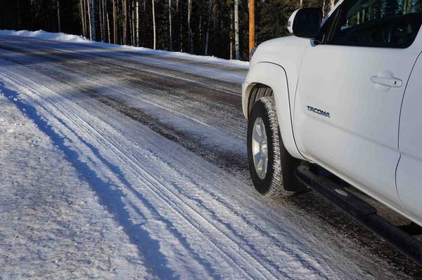

    I trimmed 7 inches off all four mudflaps.
    I used tin snips and lightly sanded with a soft sanding block afterwards. The fronts trimmed much easier than the rears for whatever reason. They definitely look better and give the illusion of more ground clearance to the whole truck.
